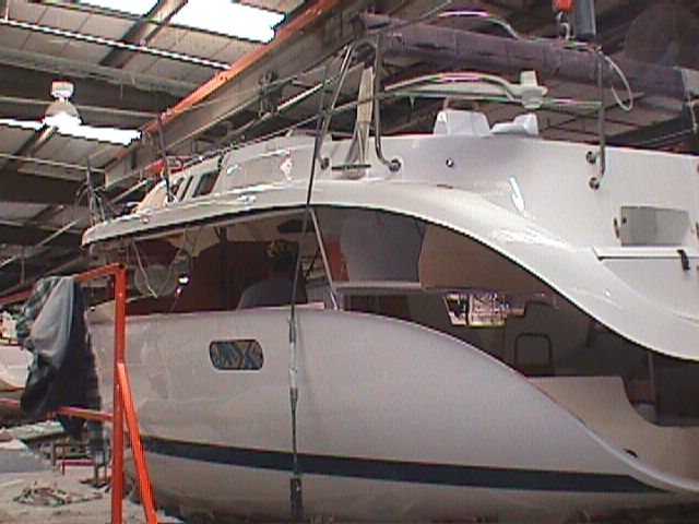

This started from the the day we bought our boat new in 2000. Our 340, had a leak in the aft cabin, port side, that soaked the walls and found its way to under the bedding and puddled up along the back cabin wall. I could push on the thin foam wall covering and squeeze the water out the bottom.
Being under warranty, the process began. I have to say Hunter really tried. They replaced ALL the opening ports and fixed windows. Rebedded the Arch and even replaced and rebedded each snap in the cockpit the hold the cushions.
Nothing worked, I spent days in the rain trying to chase water.
On the 340 there is an access panel about 3 inches wide, with about 30 screws above the fixed window. I removed the panel to look in to see if I could see any signs of water. My hands still have the scars from the sharp fiberglass edges inside there. Be careful!
That's when I saw the cause.
When they built our boat, during the process of glueing the foam wall covering to the hull, they draped the foam over the edge of the hull. Then in the process of lowering the deck to the hull they never cut the foam away from the edge and sealed th deck to the hull.
The water from the Rub Rail would find its way to that area and the foam sucked the water up like a sponge and saturated the foam all the way down.
I took an Exacto Knife and cut the foam along the inside edge, about 8 inches long, pulled it away from the area and never had water since. I did caulk the area under the Rub Rail just to be certain and all is still good.
When they were building the boat, we asked Hunter for pictures of the process and they sent about 10 or so pictures in varying stages. (There are more on my media page). And sure enough if you look close you can see the foam over the edge. Look right behind the guy standing in what is now the locker in the aft cabin and you can see the foam.
When I contacted Hunter and explained what I found they were shocked as I was. Checked my pictures and agreed. I guess I have the only pictures of it.
We can't be the only ones who had this problem in various edges along the boat, given their technique at the time. So it's a place to start looking.
