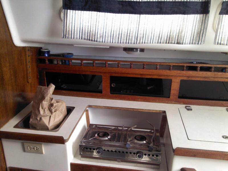

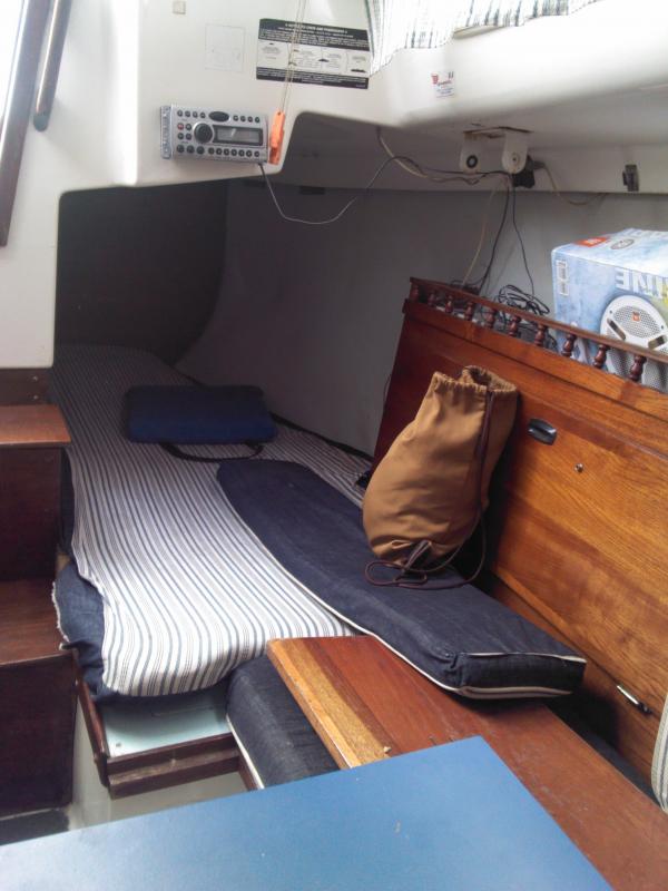

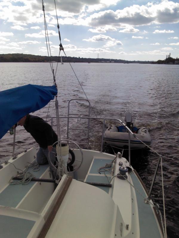

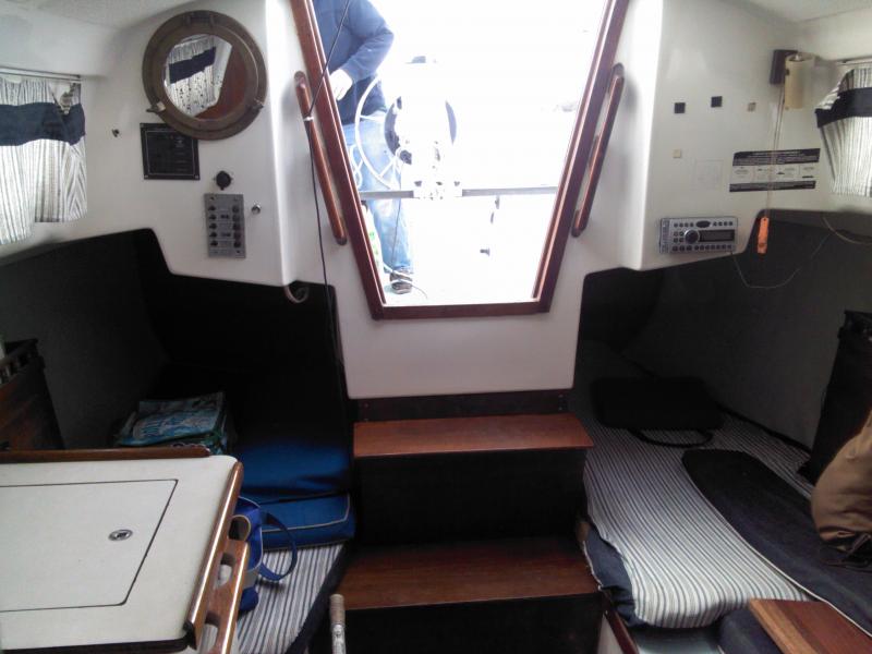

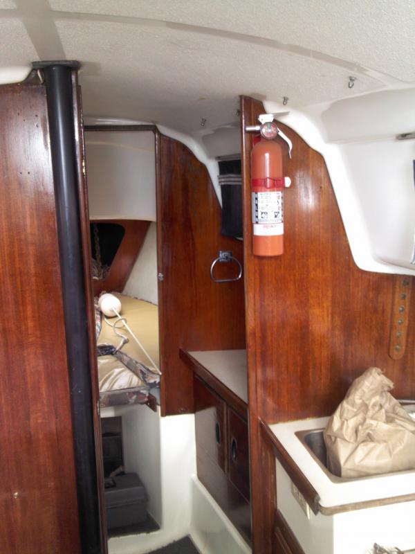

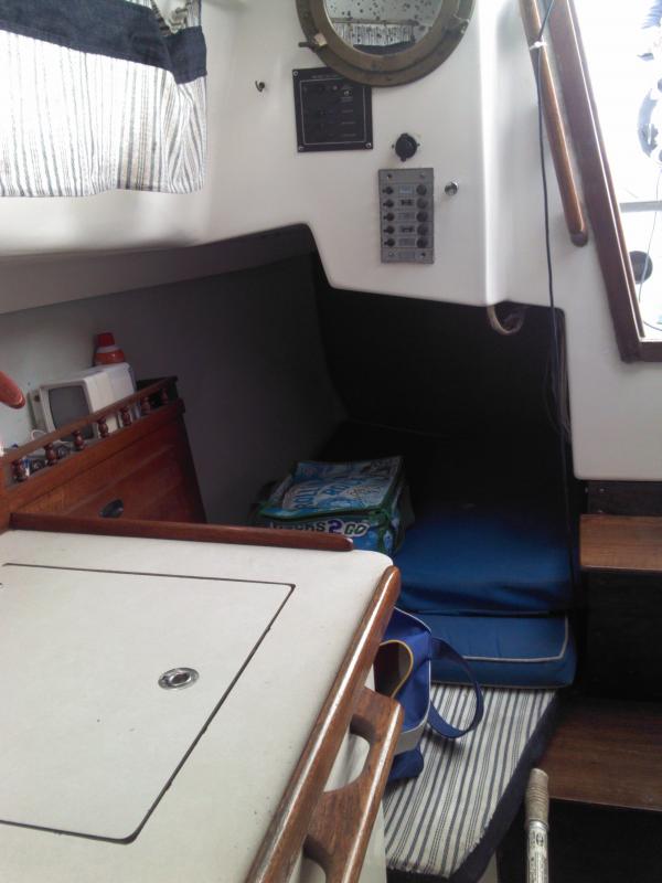

After the first trip with my best friend, on a pretty calm day (for Beavertail), I realized that sailing is really how I wanted to navigate the waters around me. Five years later, I've grown to appreciate and respect the art of sailing and just couldn't wait any longer. We looked a many boats from $800 "mooring sitters" to a 33' Pearson, we landed on an O'Day 27 and both finally agreed that this was the one. It's a 1974 and in pretty decent shape. Typical of the year, the saildrive is in need of some work, but the previous owner had already succumbed to the outboard and threw in a fairly new 8hp Merc. I picked her up on Sunday floating to the head of the Taunton River in Dighton, MA and she's heading for my backyard in Fairhaven this week! So, I took a couple of pics... please let me know what you think... not only about my deal, but the O'Day27 and Saildrives in general.

Congratulations. Looks great.

Congratulations!!! Nice looking boat. I say sell the outboard fix the saildrive.
