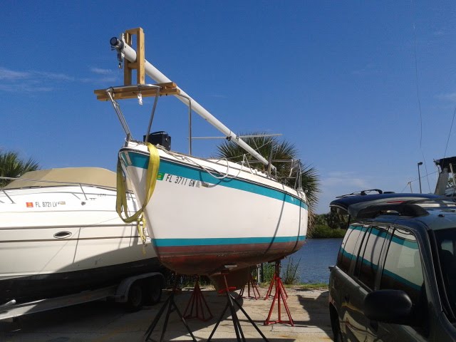

From the notes I made on Friday, my keel wasn’t sitting on the keel pad. It was about 5 inches too high. Also, the bunk curvature was too straight. So I lowered my center two uprights down approx. 5 inches which gave the bunks the correct curvature. I also built a roller for the nose of the boat to sit on. Thank god I had my air compressor/air ratchet which made the adjustments easy. I finished all the work about an hour after the marina workers workday was over. So I had to wait until today to get the boat back onto the trailer.
This morning I arrived at the marina and we got started. The marina workers brought over their fork lift and we attached a strap to the bow to lift the bow up off the stands. We moved the front two stands and the middle two stands out of the way. We rolled the trailer in place, and then lowered the aft stands until the stern rested on the bunks. The forklift operator lowered the bow of the boat then I assessed the trailer. The roller I made for the nose of the boat was too low. One of the marina workers suggested I move it back to another cross member. Also, the keel was about an inch off the keel pad. So we lifted the boat back up off the trailer, I had some cut up 5/4x6” boards that I slide along the keel pad. I also moved the nose roller back. We lowered the boat down onto the trailer and it fit quite nicely. The tongue weight (one of my many concerns) felt properly balanced. We back my Jeep Grand Cherokee up to the trailer and hooked it up. I put cargo straps across the bow and stern for added peace of mind.
I towed it home (about 20 mi with relatively flat land except two bridges to cross) with no issues. I was able to tow at 50-55 mph down US1. Once I hit 60 mph, I got some sway. So I slowed down and kept it at 50-55 mph. It is now parked in my driveway for me to work on. I have some discoloration beginning to develop along my bulkheads so I am going to remove them to see how bad it is. The p/o replaced the bulkheads about 3 years ago. If it’s not that bad, I’m going to seal it up with epoxy and set them back into place. I also plan on repairing the transcom because I do have some coring rot at my motor mount. I’m going to remove all deck hardware and check the core around all the wholes. I’m praying the p/o sealed it up. If not, I’ll get that done. The rest will be cosmetic work. I have a few scrapes on the topside to repair and I want to repaint the deck and non-skid areas. I probably will replace the rub rail while I’m at it.
