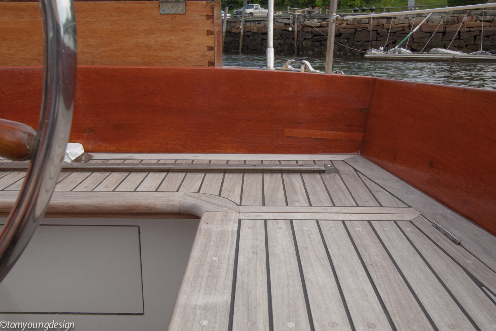

Whenever I have a crack to fill, I do a Dutchman patch. A small crack can usually be filled with a feather or sliver of the same species of wood. A thin rip of material with a little bevel will slide snugly into a varying split or crack that runs with the grain of the area to be repaired.
A little bigger crack might require a bigger patch. Sometimes it's easiest to cut the whole crack area out with a plunge router.
However you do it, the Dutchman epoxied in becomes a part of the wood to allow expansion and contraction. Filler won't usually do that. Plus it's tough to match filler with the surrounding wood.
