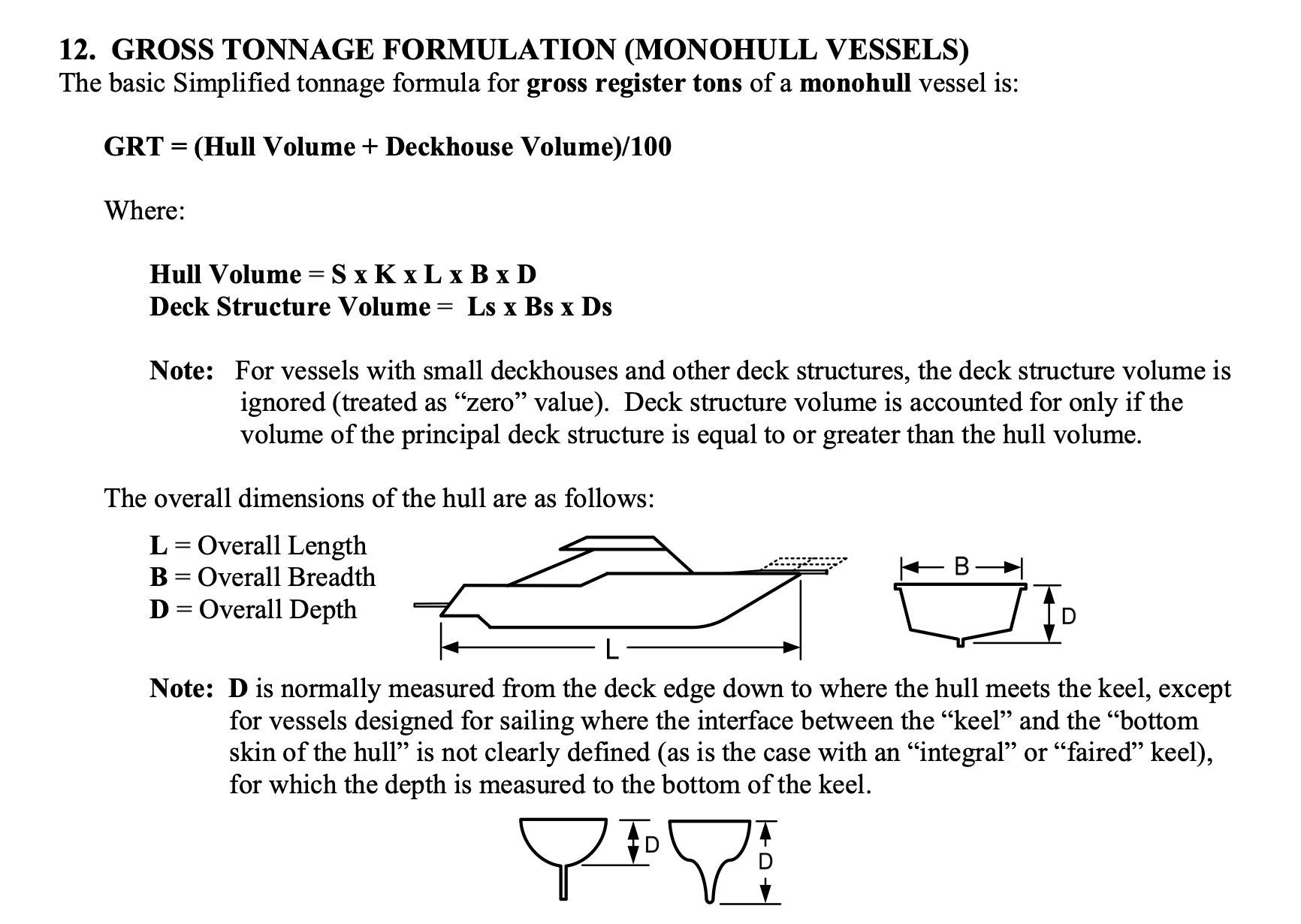

I have a Hunter 31 and I am trying to calculate the GRT. Some sites say to use the depth of keel and others say to measure from the gunnel to keel and one says to measure from top of cabin to keel.
GRT=(0.375 X L X B X D)/100 L and B are straightforward, has anyone determined the GRT for a Hunter 31.

The height from keel to gunwale depends on whether the keel is encapsulated or bolted on
Encapsulated hulls are measured from the bottom of the keel. Bolt on keels measure form the bottom on the hull which the place the keel attaches.
If you are looking to document the boat there is a measurement form on the USCG documentation center website.
