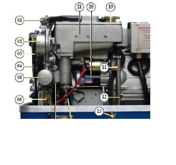

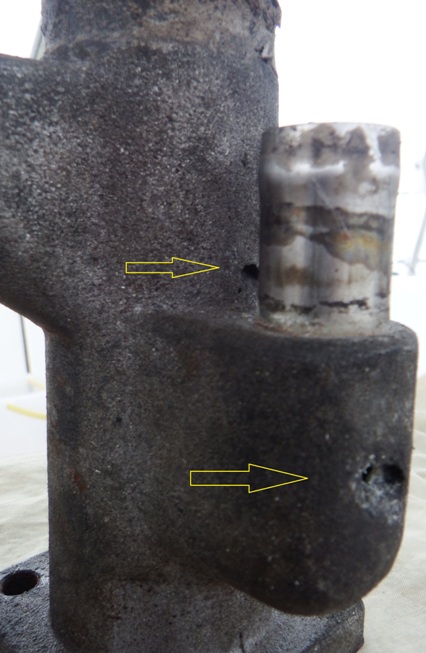

I have a Ficher Panda 12 Mini in my 2008 Hunter 49. The Ficher Panda Genset now approaches 2500 hrs continues to chew up exhaust water mixers at an alarming rate of about 1 every 600-800 hours.
I will attempt to attach pictures to this entry.
I am looking for anyone who has the same genset with or with or without these problems and would be really great if I could get another Hunter 49 owners experience in this area.
The following are some lines I have followed;
1. Firstly I thought just bad luck, faulty from manufacture etc, so replaced, the genset had done about 800 hours then.
2. Next time I spoke to Ficher Panda whom where very helpful, and they said it could be a potential difference ( electrically) between where the water gets injected into the exhaust and hits the side. This seemed reasonable as the whole was consistent with where the water would hit. I had already looked for any electrolysis type action caused by stray currents and could not find any sign, but I added and earth wire from the mixer to the main body genset earth.

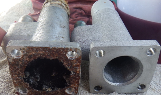

3. Next time around I mistakenly took the very black lumpy appearance on the inside of the flange where it bolts onto the manifold for Carbon build up, and attributed this to possibly insufficient load for clean burning. To load a 12 kw genset is not so easy even on my boat, but I made a point of seeing that the unit ran with a load of at least 20-40%.

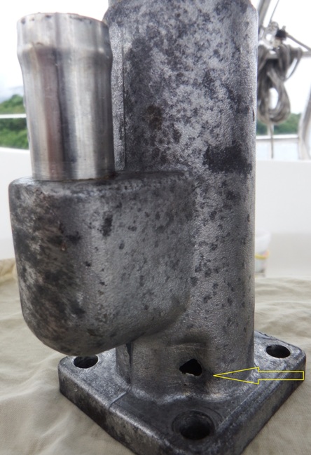

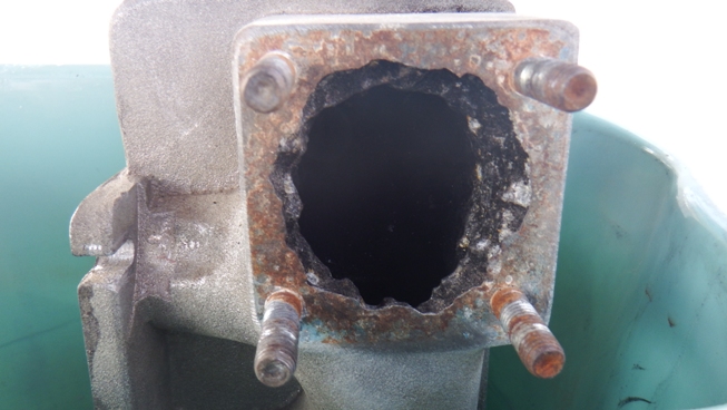

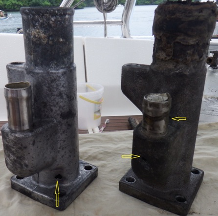

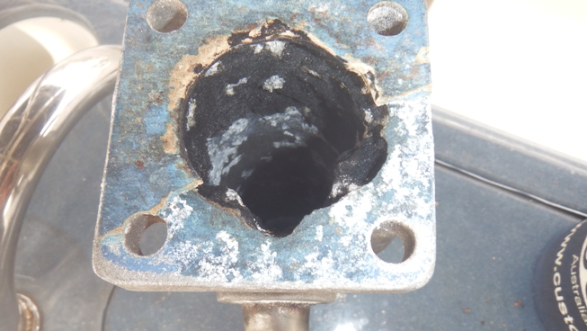

4. No the latest one I realize there is very little carbon but major erosion that is chewing through the cast alloy indiscriminately. This latest one has two holes and one is just before it gets to the mixing are or main exhaust flow. The erosion is occurring in both the mixing elbow and in the manifold most predominately within 2” of the flange. What is about to fail now is the manifold itself is suffering this problem around the flange and will soon collapse as well and this will be a very costly part Im sure.
I am now pondering if this is exhaust back pressure related because the problem seems to be only within the last 1 inch of the exhaust manifold and on through about 2” inches into the mixer. For example the far end of the mixer where it is thinnest from new and the exhaust hose is connected has never shown and problem, and also back up in the exhaust manifold, ie further inside, the manifold seems fine.
