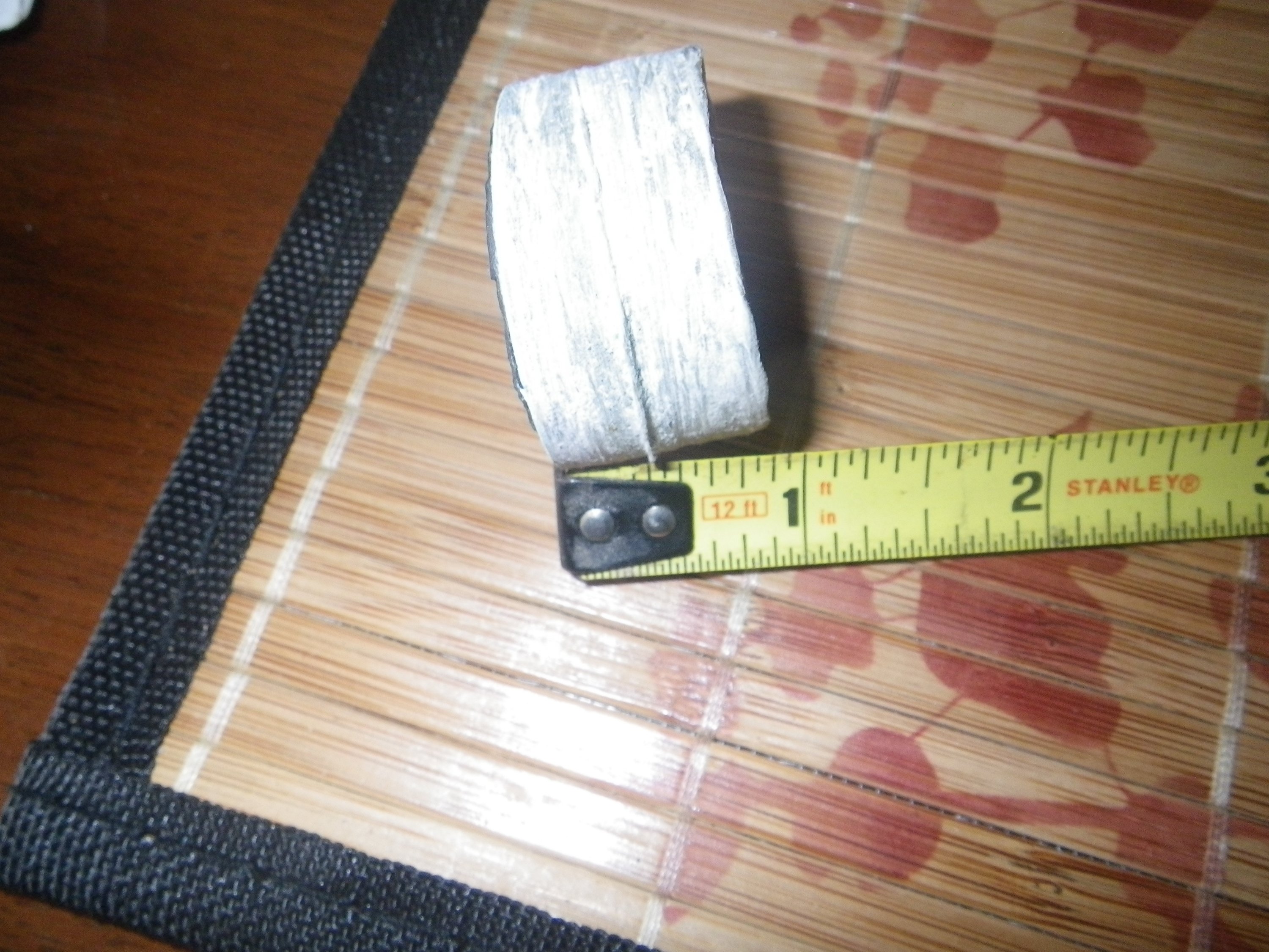

Sounds great, keep in mind that the water pressure is very low so you shouldn't have any trouble. In scuba training you are taught that at 33 feet is one atmosphere or 14.7 psi. So if your transducer was say 2 feet deep it would only be about 1 psi. If your through hole fitting was 2 inches in diameter you would have 3.14 square inches so the force on your patch would be about 3 pounds. I think you can sleep at night now.

Gee I thought I was being conservative since the hole is probably less that 2 inches in diameter. Also flow of a fluid over a surface tends to decrease the pressure this is why airplanes can fly. I agree if the boat launches off a wave and is temporarily airborne and smashes into the wave trough the pressure on the patch might go up a little bit.
