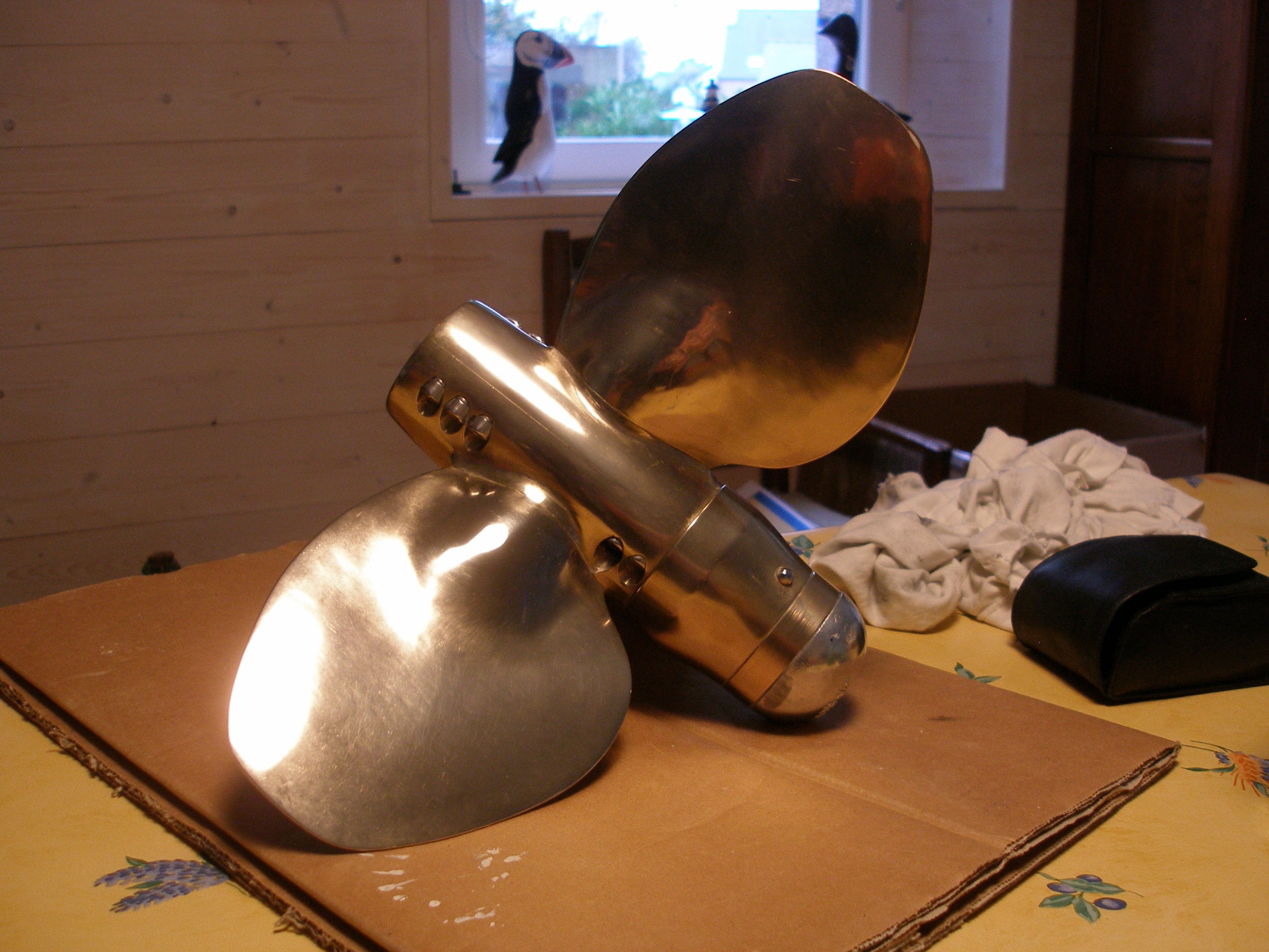

P1010021.JPG I installed a J Prop on my Oceanis 31 and I'm very satisfied of the results : it's facilitate the port manœuvre when I back up and under sail I gained about 0,5 to 0,8 kts.
The only negative point is its price !
