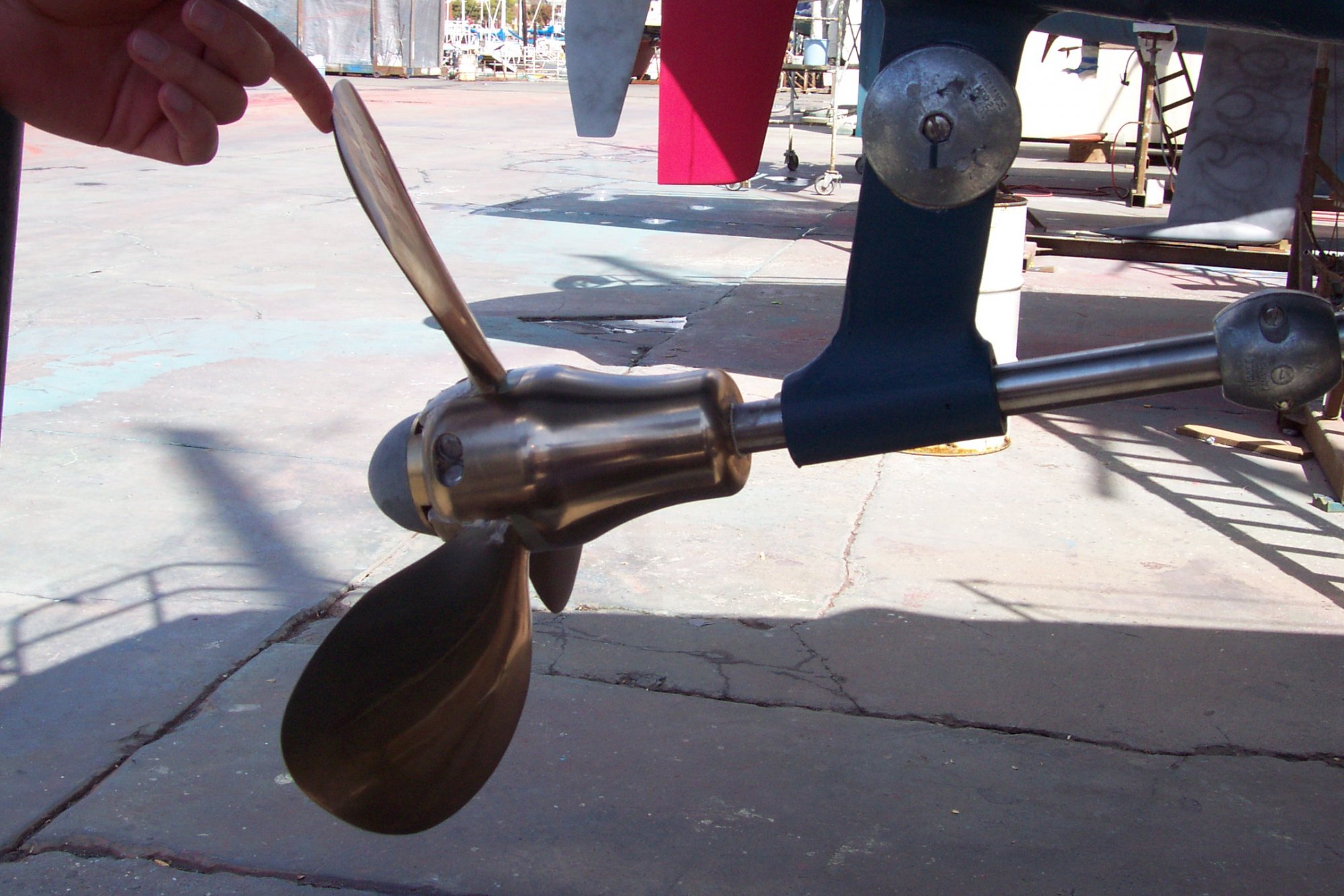

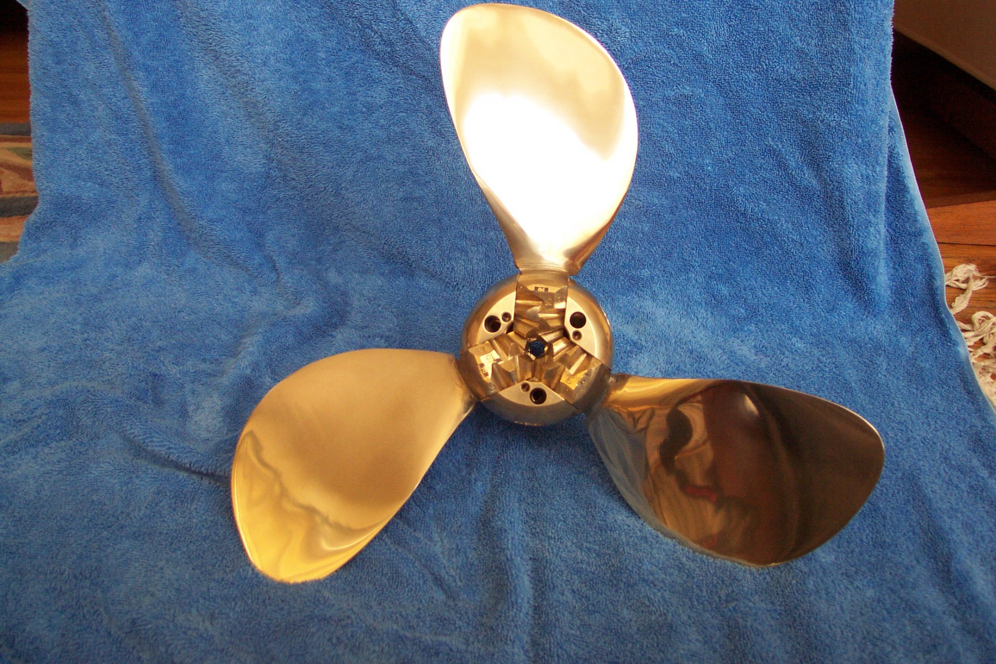

My 2 cents: I don't race. My cruising is generally under 50 nm/day. But I do like to sail as fast as possible. So I replaced my OEM 2 blade prop with an AutoStream 3 blade feathering prop 20 years ago.
Comparatively expensive? Yes. But the performance is very noticeable. Up to 0.5 kt faster in light air. Reliable to open and feather since all blades are geared together. In reverse the blades flip so that the leading edge in forward is still the leading edge in reverse. This results in unbelievable stopping power. Three blades let me power through heavy chop much better. And I chose the AutoStream because it was all stainless (no different metals with the stainless shaft) and it was the only feathering prop at the time that could be re-pitched for forward or reverse while in the water, and also greased in the water. Since I was going from a 2-blade to a 3-blade I was concerned about getting the pitch correct.
