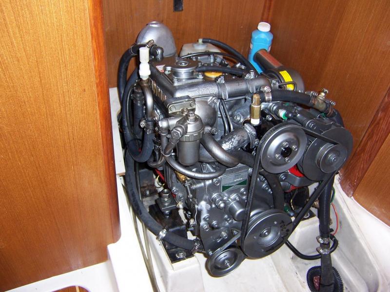

For the generator, Yanmar 2GM20F's don't like to be idled for extended periods. Carboned rings, carboned valves, and carboned etceteras. Any alternator you added would have to be 110V and looking at mine, I think that mounting an additional alternator would be difficult at the very least.

An add on belt driven generator could be either AC or DC, its really your choice within reason. Like how much room you have, how much power do you need, and how hard do you want to run the engine. An 115V AC generator really needs to be governed tightly at the specified RPM of the Generator to keep the cycles at 60. An alternative would be a DC generator and run AC power off an inverter. That would allow you to use the current engine throttle as is and greatly simplify the setup.
Ralph made a point about idling. Its really bad for a diesel. But if you spin it up a ways and keep a decent load on it it wont bother it much. And if you get it out and run it hard once in a while a little idling wont hurt it much either.

2. Ralph's objection to the generator is spot on. I'm supposed to replace my mixing elblow on Yanmarr 18 every 500 hours, but had to do it last week at only 300 hours because it clogged up. Even though I run at optimal RPM of 2800, I sail 100 days a year and therefore make 200 runs in and out of the harbord at lower RPM. That clogged it at 300 hours. A generator would merely hasten the demise of the mixing elbow.

The builders/first owners of our 42' Cascade were both Boeing engineers. Originally the boat had a belt driven generator and the whole electrical panel to go with it. You could even adjust the altanator out put for charging the 12 volt battery bank while the engine was driving the belt driven 110 generator. While the 2nd owner owned the boat the jack shaft froze on the generator and he replaced it with a 6Kw Northeren Light Genset. The belt driven setup required a 2 belt pulley be attached to the water pump which over time caused the water pump to take a dump. We had a spare water pump onboard which was nice given that the engine is a Mercedes Benz OMB 636 4 cy diesel which means you do not run down to the parts store and get a replacment. When we replaced the water pump we replaced the the pulley with a single belt pulley setup to eliminate the stress on the WP. The dock side city water setup goes through a 40-50 psi regulator before being attached to the boat. Once attached to the boat it goes into a check valve setup that has a washer infront of it which has been designed/enginered to allow no more water in then the bilge pump can pump out in a (2,500 gallons) given hour The water line then goes down into a 15 gallon pressure tank which can be pressurized with a bicycle tire pump. The water line then goes forward through a Y valve which allows for the fresh water tanks under the vberth to be filled or to pressurize the fresh water system.
