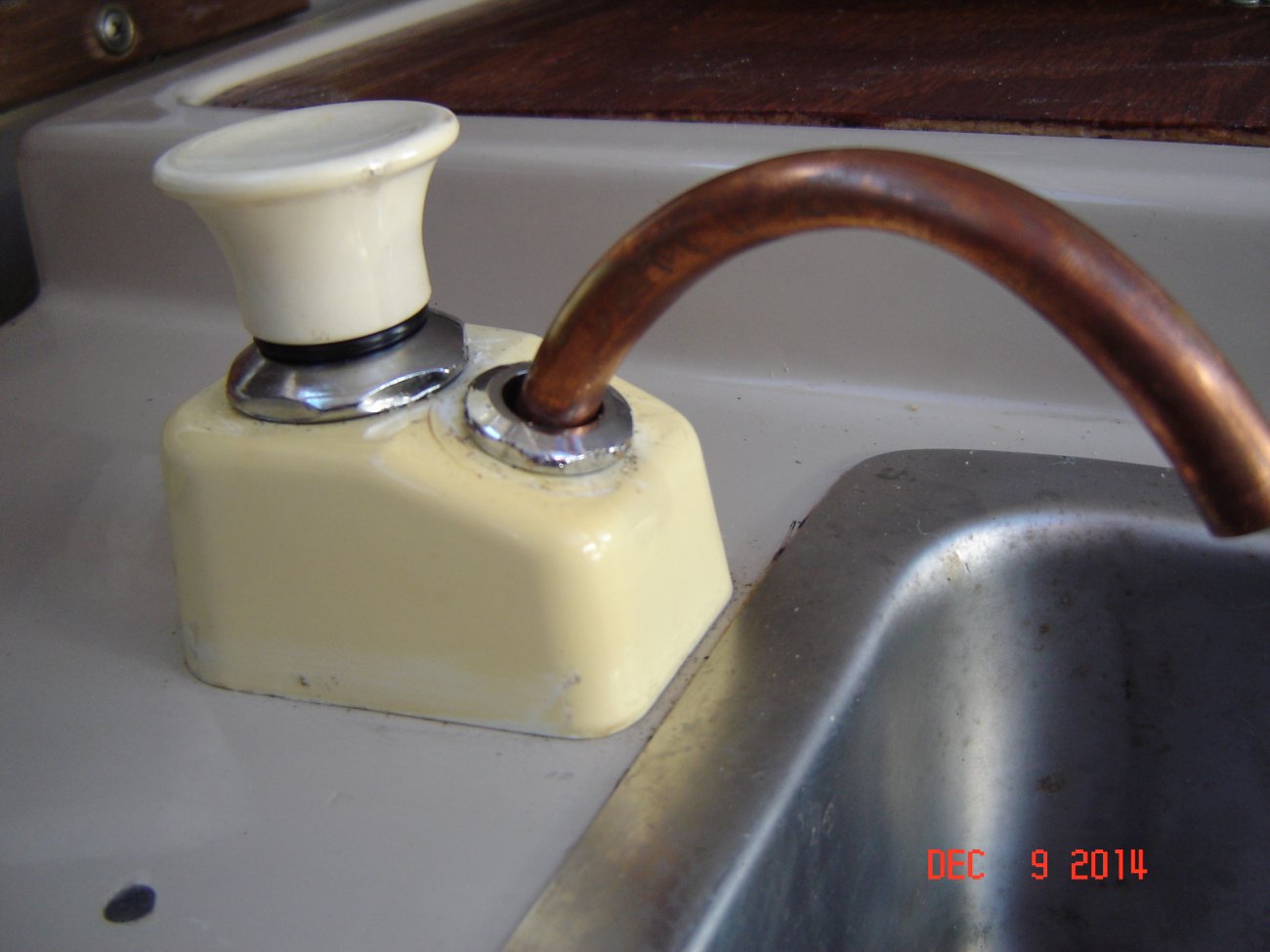

Make your own spout out of cheap piece of copper tubing.

Make your own spout out of cheap piece of copper tubing. View attachment 163928
That was what I originally did. Both conventional copper tubing and metal brake line tubing were the wrong diameter and leaked badly at the pump. I tried a larger o-ring but the tubing is still loose in the pump so it still leaked. I could simply sealant the tubing in place, but then it would never be removable.
I wish I had the boat here so I could measure it's O.D. again. At the time, all local companies I contacted had nothing with the correct O.D.
hmm... The photos and install info of the current Whale V have me wondering if the original pump also has a long shank on it and is adjustable height. I have always assumed it was simply designed to be flush with the countertop.
