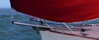

(1) a somewhat traditional (high $ more complicated engineering)unguyed pole through an eye at the bow with the tail mounted immediately behind the anchor well.
(2)(low$ simpler) pole mounted at the forestay head with stays clipped to new eyes on both sides of the bow and the bow eye (NOT like simple pic below).
I may end up with some combination of both. The DR will be in surgery. pray for the patient
