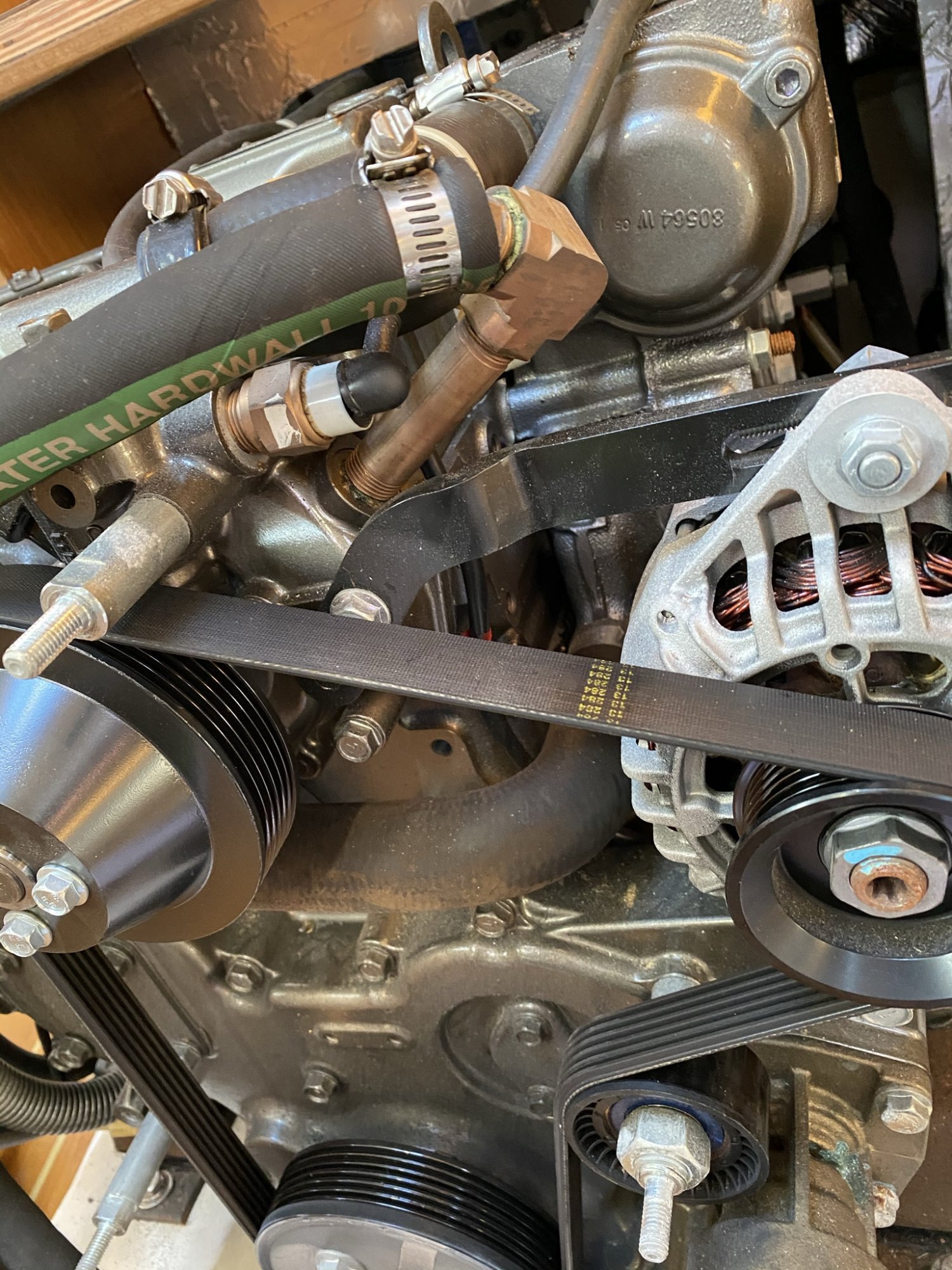

I've just crossed 5 years and 500 hours on my Yanmar 3JH5E. I'm pretty sure I'm dealing with the original belt and original impeller. I've not had any significant issues with engine performance but I have noted that when running WOT, the temperature does seem to be about 10-20 degrees hotter on the temperature gauge than it was originally.
I will be flushing and replacing the coolant this year (I think its been 3 seasons since I last did that).

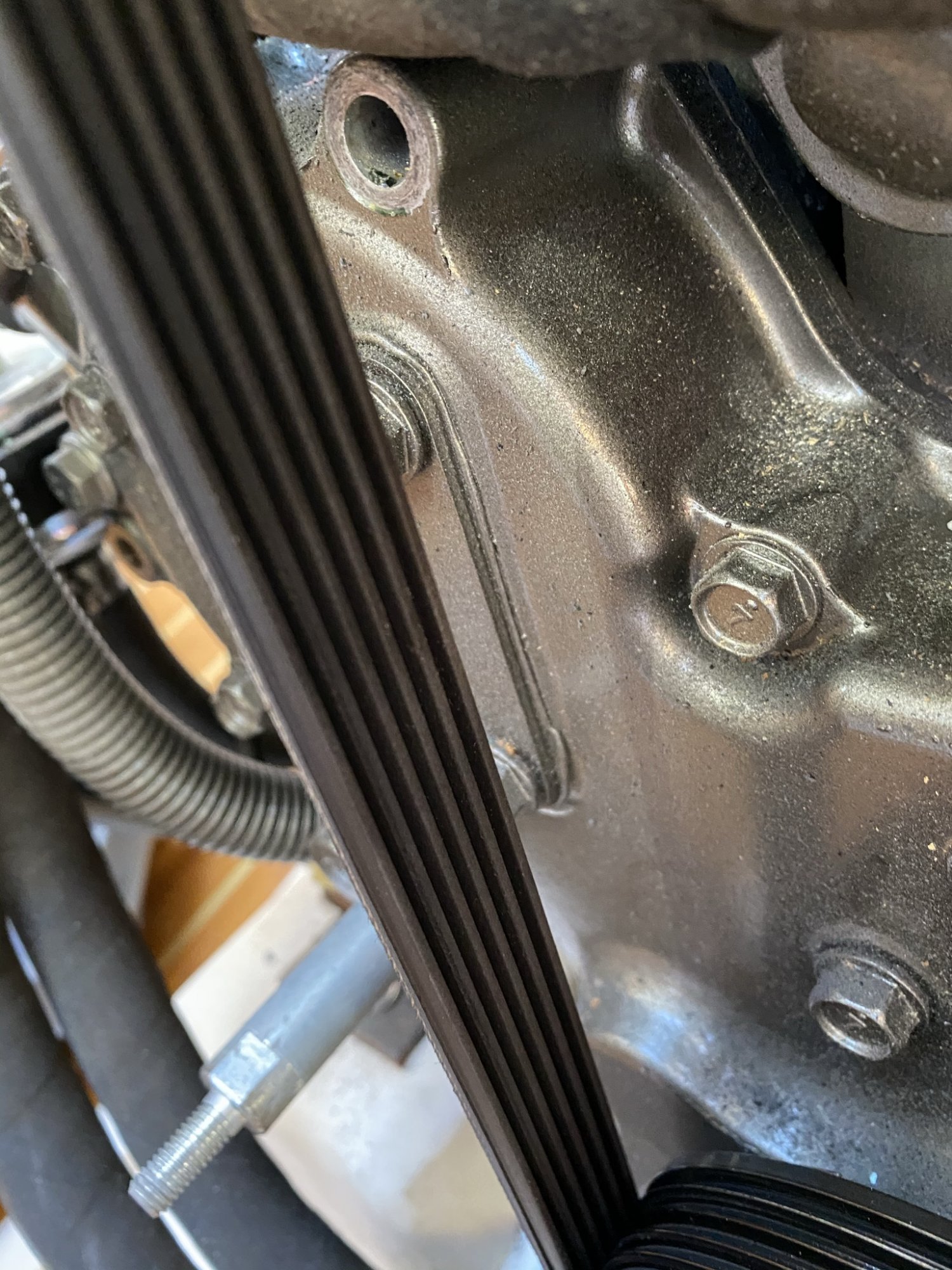

I'm trying to determine whether this belt should be replaced. It looks almost brand new but I was just reading that some of the newer belts don't show the wear the way the older belts showed.
Any opinions?

Is there a stated time period to change this belt for your engine? From the photos I see an alternator on the belt and one other thing I don't recognize - looks like a water pump? I don't know.

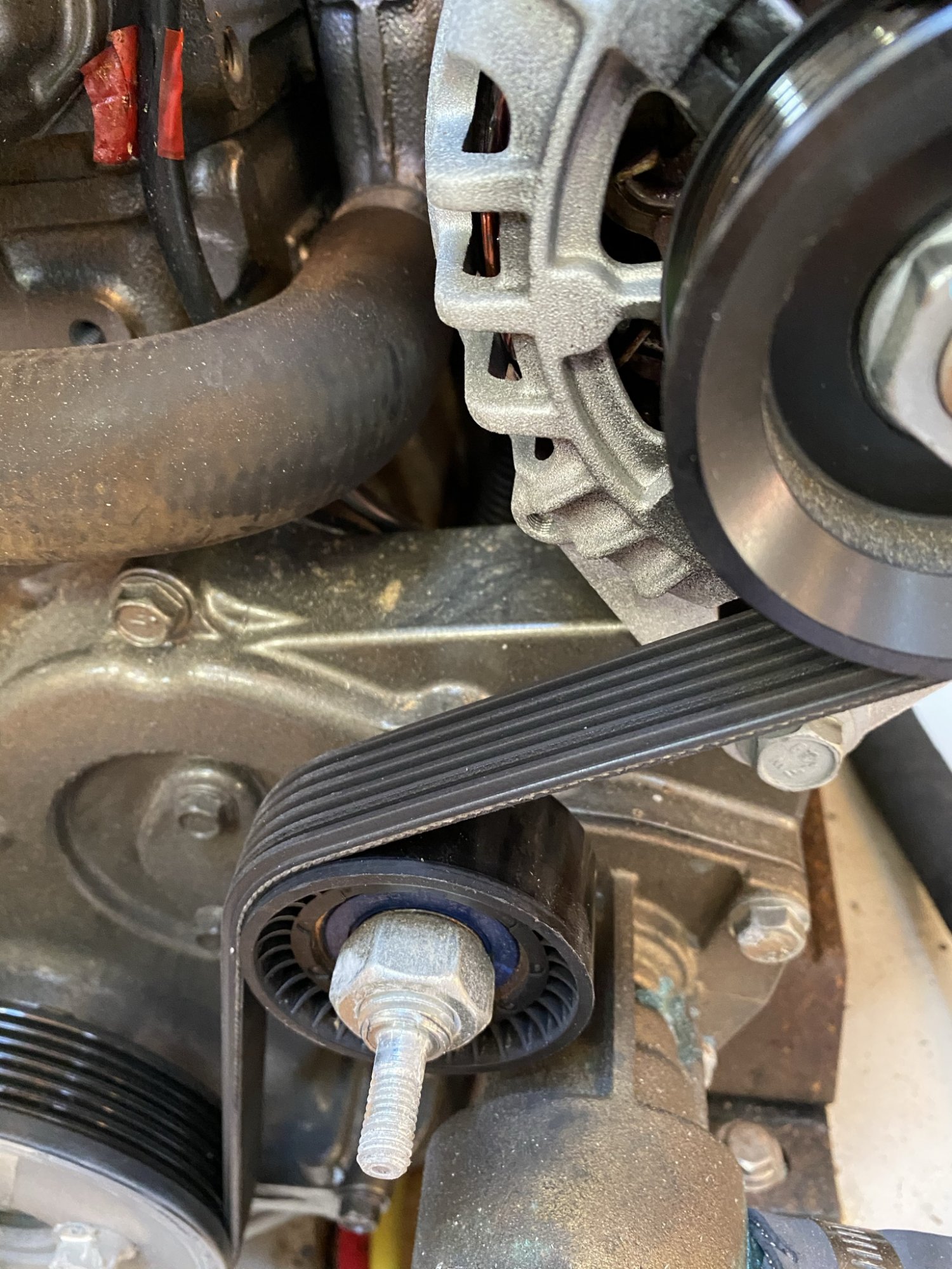

The internal freshwater pump is up and to the left of the alternator and is driven by the serpentine belt. The seawater pump is driven off of a PTO on the port side of the engine, it is just to the right of the idler wheel in the photo.

You are fortunate to have a serpentine belt, and it looks to be in very good condition. The v-belts, such as the one on my engine, wear fairly quickly, and require occasional replacement.
The impeller, however, on your raw water pump should have been replaced a couple of times by now. The rubber that the impeller is made of deteriorates with age, so it should be replaced periodically, regardless of how many hours are on the engine.

In my case, with the Yanmar 3JH5E I have absolutely no excuse.
The impeller pump cover faces forward completely unobstructed. The fan belt comes off with three bolts loosened. One of the three bolts is a tightening bolt on the top of the alternator.

As for my impeller, all vanes were intact but it was past its end of life. I removed it three days ago and the vanes are still in their compressed position.
As for the fan belt, it too has taken on the shape of the pattern of its mount ...
Not sure these are going to be replaced annually but I will be removing them from the engine during the winter moving forward.
