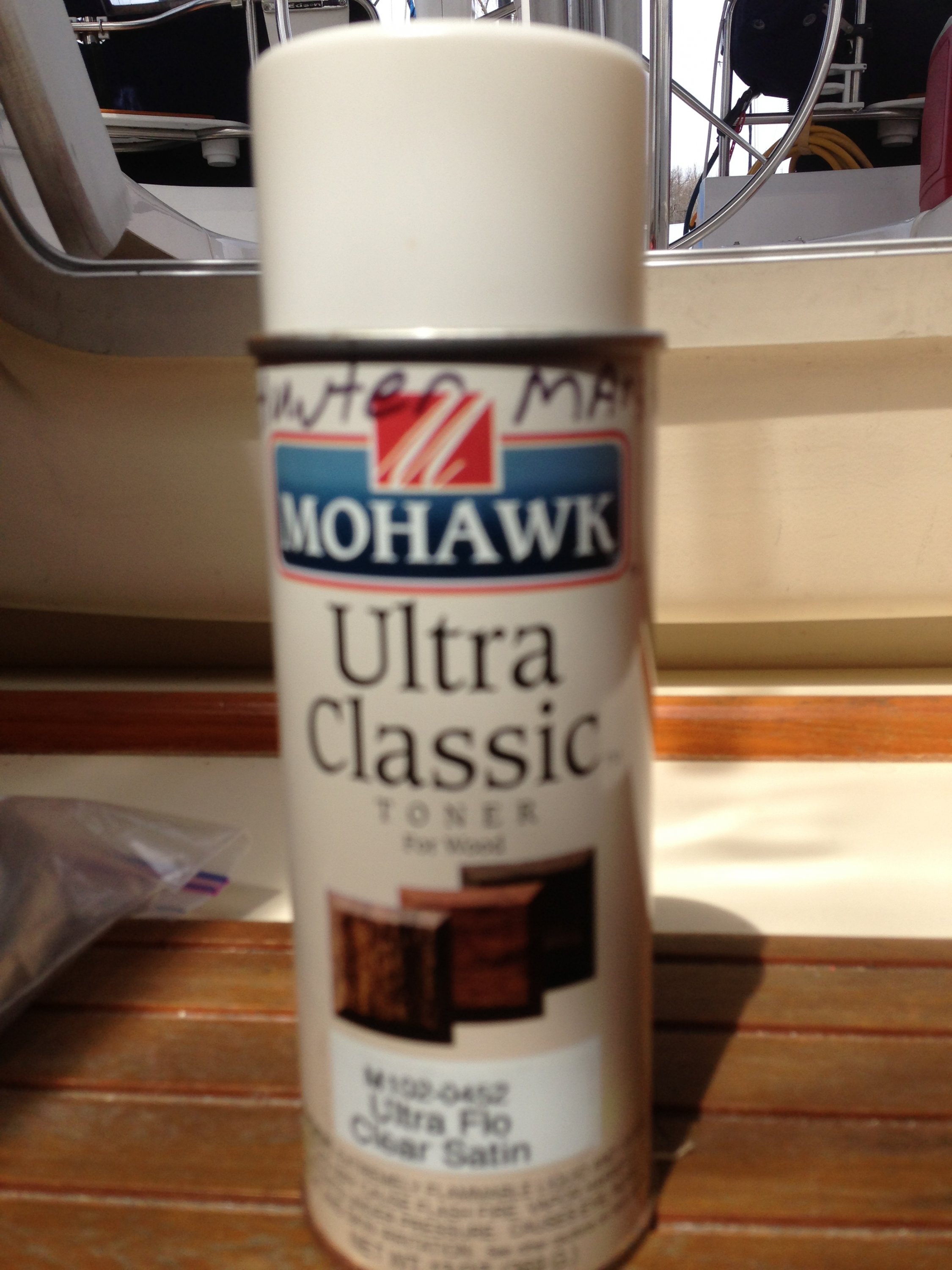

My 03 H356 is real wood. No fake teak. Plywood is veneer. It can all be touched up with a Mohawk product that sprays on. See the photo of the product Hunter furnished with my boat.

Ditto! I have to say I always liked oiled teak, but the spray varnish used over real teak on the 356 looks really nice and has held up really well, As jerry said, it's really easy to take care of - we just use lemon oil polish every spring, cleans, shines, and kills any mold spores. I was really disappointed when they went to the fake wood in the 36

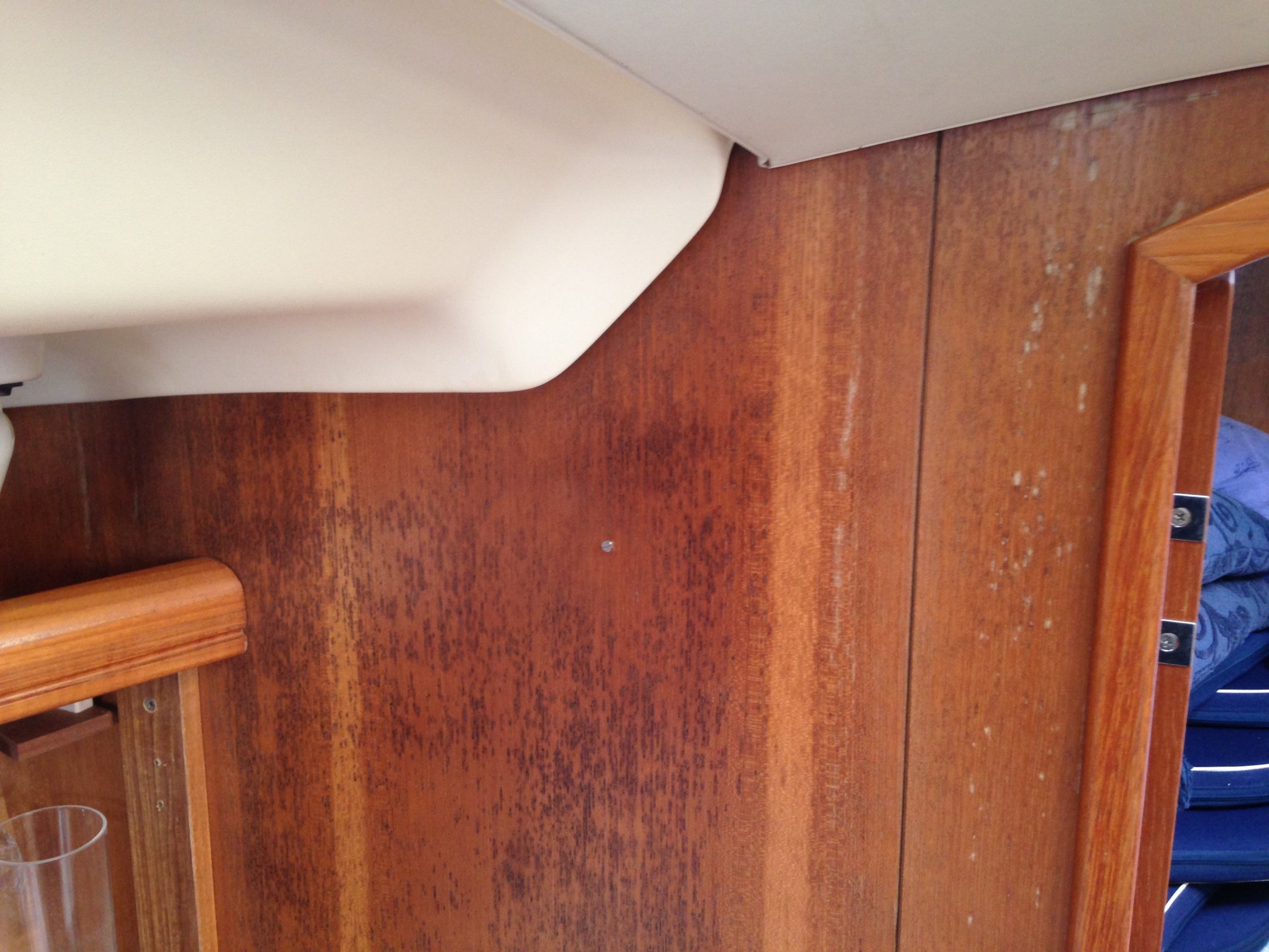

Its all ply with Teak veneer except the double doors to the front cabin which are solid Teak. My boat was very unloved and most of the Teak veneer is blackened with mould. I have had to rub down (very carefully!) the Mohawk laquer to get rid of the mould and make good. Distilled white vinegar is excellent at killing the mould and may recover some problem areas.
