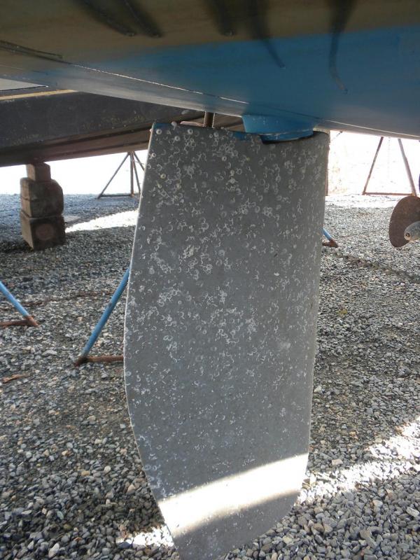

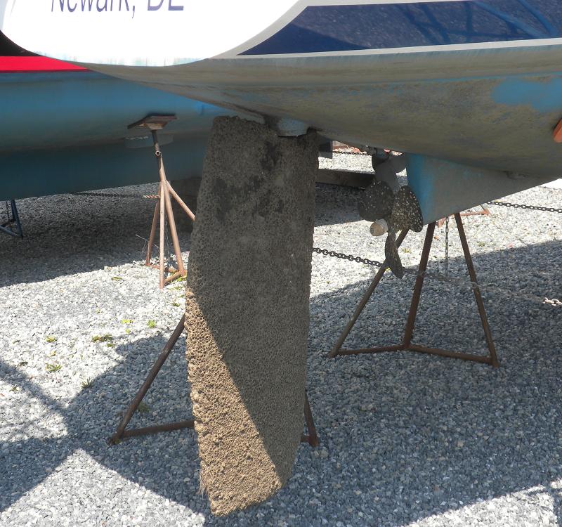

I purchased a Catalina 309 last spring, hull #190. We had the boat hauled out in late August for hurricane Irene and discovered and extreme amount of fouling to the rudder. First and most common question from the folks at the marina "was it painted with anti fouling paint? Since it was a new boat that came with a fresh paint as part of the purchase I hope that it was. I contacted the dealer in Havre de Grace and they told me that it was painted with interlux Micron CSC shark white and the hull in blue of the same type. I was also told that a barrier coat had been put on. I sent them the photos and they said that water in Rock Hall is very dirty and that fouling is more common there, fair enough. That is well in good but if that is the case I would expect that the hull would have experienced the same or more fouling but that did not occur. Anyway the boat is sailed at least every other week during the season so it does not sit for long periods. I even contacted interlux with the photos and there response was quick and sincere as to determining the problem, even to the point of having someone come out and take a look at the boat when it is hauled out for the season next week.
I am not an expert but I suspect that the rudder was not painted as I was told it was or if it was it was not done properly?
Any way the point of my post is to see if anyone has ever seen anything like this.
Thanks

Guess the question is 1) did they paint it or is that only the primer? 2) does CSC work in your area? 3) what you going to put on the boat now?
I'm hopping you removed that fouling as soon as you took the picture. It going to be difficult to remove if it's still on there.
Hope this works out for you. I'm sure Interlux wants a good outcome. Have to believe your dealer does as well.
Good Luck, Pat

Sunlight has a big effect on marine growth. Our boat is moored bow&stern, and we always have more growth on the southern (sunny) side. Is your boat on a mooring or a slip that gives it a certain orientation -- say stern to the sun? There are other reasons for painting the rudder a light color and the hull a darker color. The darker a/f paint doesn't show the growth as much, so when you heel over, the boat still looks OK. The lighter paint shows growth more easily, so you can gauge when you need to have the bottom scrubbed by when the rudder gets too dark. The growth on the rudder looks like about five or six week's worth around here (CT) . We've used Micron CSC, shark white or red, for about a dozen years. There are all sorts of variables with a/f paint. Was is stirred? Was it fresh? Was it thinned? I'd show the dealer and ask him to get it cleaned off & repainted for you. You'll be happy, he'll be glad you're happy, and you can go sailing next year and won't have to worry about figuring out what the problem was unless the same thing happens again. In which case you'll owe the dealer a beer or two.

The boat has been hauled out and is on the hard. I asked the the Marina Service dept to take a look at the rudder and they observed what I have been thinking the entire time, the rudder only had primer applied and no anti fouling paint. I am still waiting for the interlux rep to take a look at it this week and hopfully they can confirm that the rudder only has primer on it. Paul I did email the photo to the dealer and I never received a response. I followed up with a phone call and resent the photo and the only response I received was that it was extreme(ya think!). If interlux confirms what my marina is saying I will contact the dealer and I am sure that the situation will be rectified. Currently I am not sensing any willingness on the dealers part to help me out at this point.

Got the final word from the interlux rep who looked at the rudder last week and they confirmed what I had been thinking all along. The rudder only had a barrier coat on it and not paint. The dealer finally agreed to do the repairs and do what they were supposed to do when I purchased the boat. Any how, I am happy that the situation is resolved.
