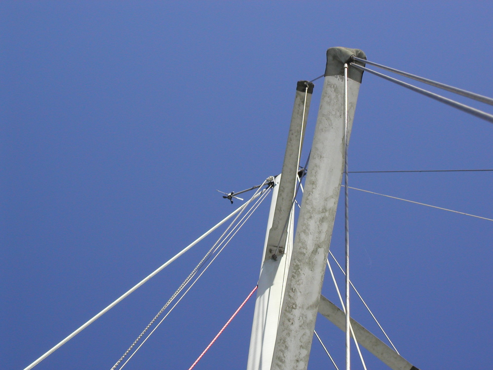

10,165
I agree, My topping lift goes into the mast just below the top spreaders.. The red line
