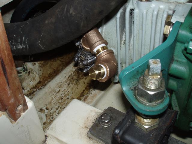

In line with Maine Sail's post, here's a pic of my flush system. I connect a 3 foot garden hose to the fitting pictured and place the other end in a 5 gallon bucket filled with fresh water. The bucket sits on the cabin sole. With the engine intake thru-hull closed and the blue handled valve in the pic open I start the engine and run it until the bucket draws down to about 1" of water.
As a side benefit, using the same technique I acid flush the engine every other year (I'm raw water cooled - no HX). Keeps everything cleaned out pretty well.

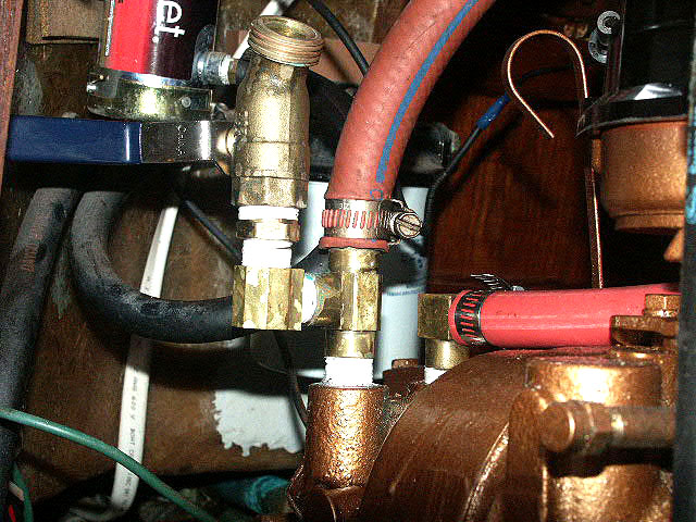

Here is a pic of my flushing T. It's mainly used for winterizing but sometimes when we get to a harbor with very dirty or muddy water, I flush the engine with a bucket of water before settling for the night. Just a peace of mind thing.
