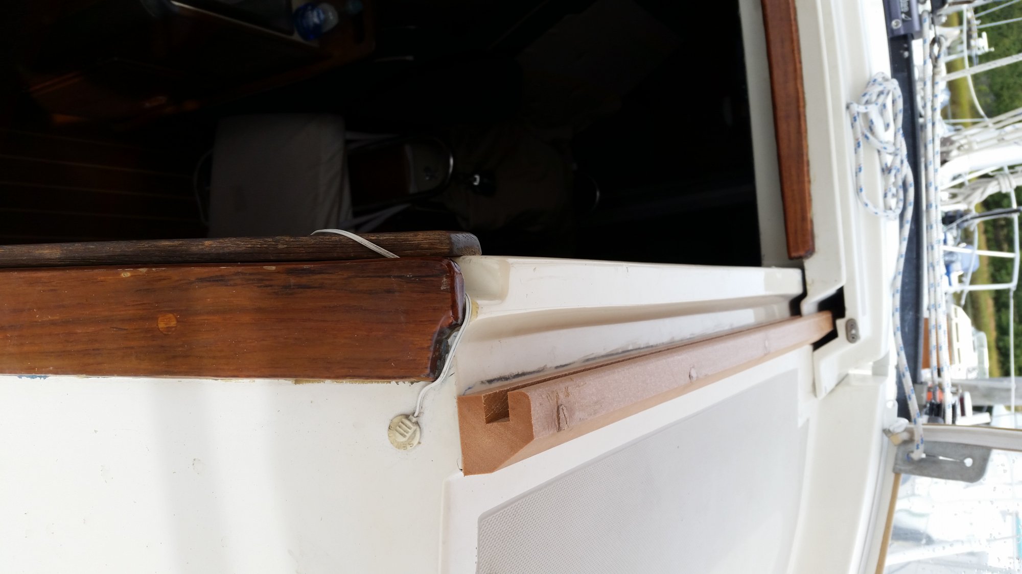

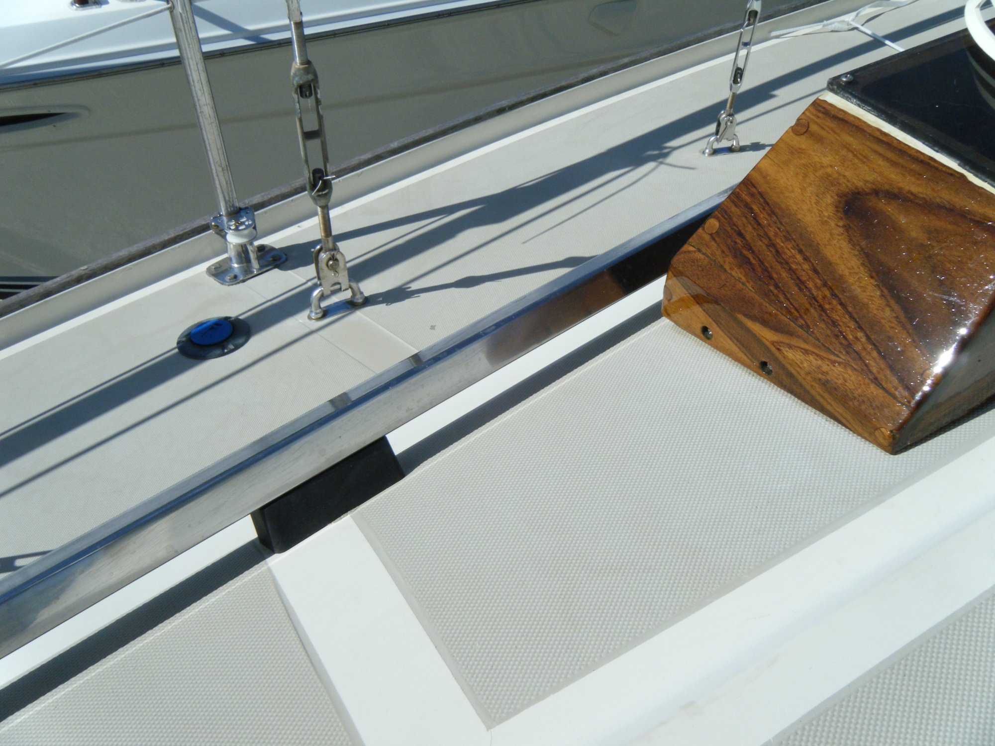

I have epoxied and varnished the companionway hatch retainers and the dorade boxes twice. Any teak that you see in the pictures below is epoxied and varnished. The next improvement to my 35 will be to replace the companionway hatch retainers with HMWPE (StarBoard).
I have replaced the teak hatch slide rails on my boat with HMWPE, milled to the same profile as the original rails. This was a VAST improvement.
I replaced the cabin top hand rails with polished stainless steel box tube. This was also a HUGE improvement.
I have not yet done anything with the teak toe rail, but I do plan to replace it with something that requires less attention than teak at some time in the future.

Eherlily: nice job on the hatch slides and hand rail (interesting solution).

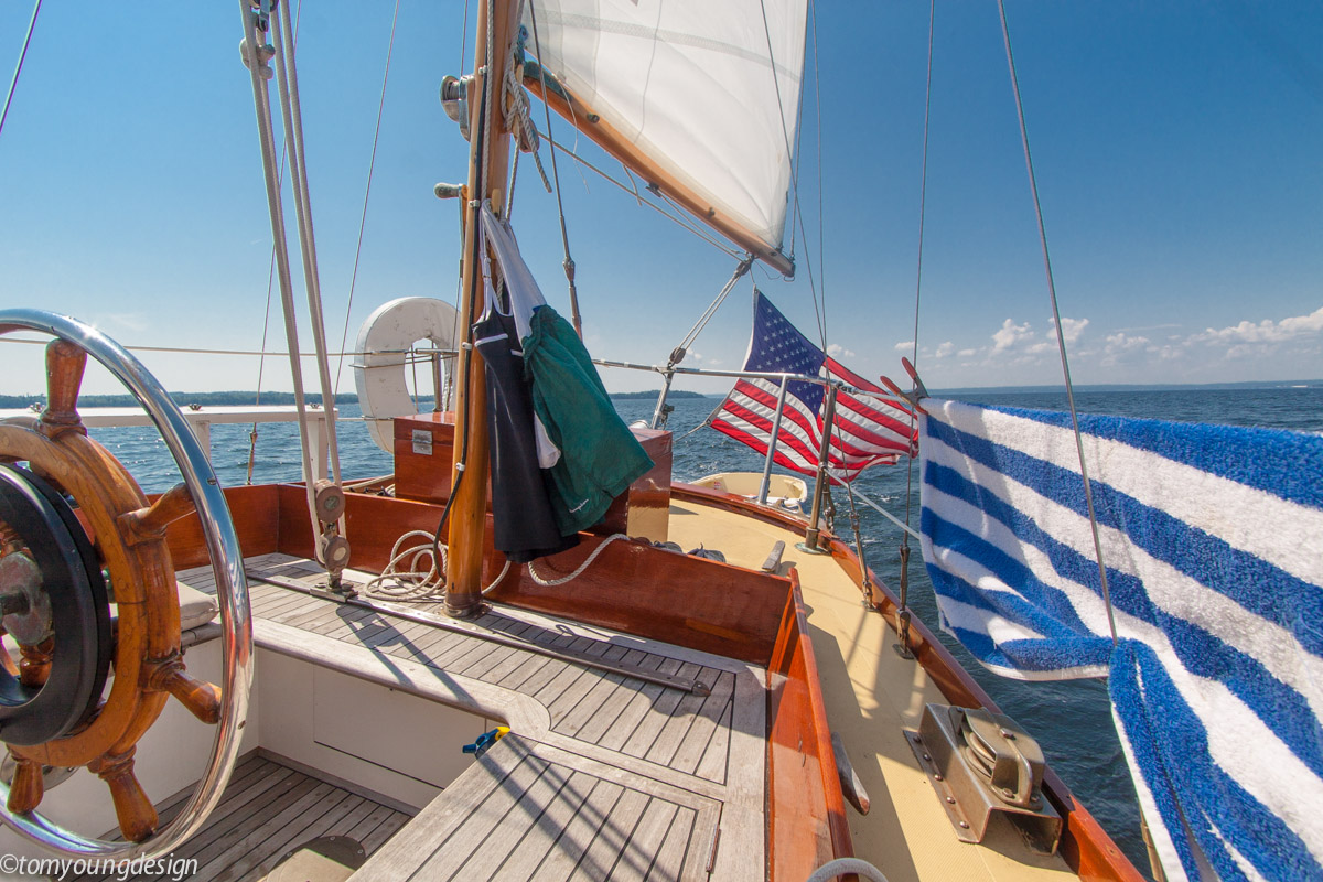

There may be some confusion in this thread as to 2 different types and purposes of wood, on a boat.
One falls in the general 'brightwork' category which are exterior hardwoods (that may or may not be teak), that are usually protected by a coating (varnish, oil, pine tar, Cetol or similar).
This category are primarily structural parts; toe rails, cockpit coamings, hand rails, spars, hatchway parts, etc. These parts are usually protected from deterioration of weather by any coating. With regular maintenance, brightwork parts can last nearly forever.
The other category is decking you usually walk on, that is not often protected by a coating. Wood decking is usually teak wood, but not necessarily. 'Teak' decking wears from foot traffic and the worst UV exposure (due to it's angle to the sun) Teak decking has a life span mostly determined by it's thickness and use/exposure. The wear is a slow process but teak decking is sacrificial.
The parts on my old boat, brightwork, that are protected by a coating in this photo(I use varnish), are all original and nearly 60 years old. I suspect that with the same maintenance, these parts could go another 60 years (that is if the fiberglass hull lasts that long, which I guess it will).
The 'teak' decking on the cockpit sole and seat top which are heavily tread on, is a few years old (it's IPE, another very hard rot resistant tropical hardwood). It wears away, slowly. The original teak decking started to require replacement after 30-40 years. Maintenance was in the form of washing and re-caulking when needed.
