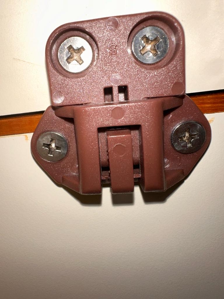

Just bought a hunter 49 and wondered if anyone could help explain how to extend the table. Mine has 4 clips that seem easy to undo but then there are 4 x brown clips that I have no idea how to undo - looks like you need some kind of key to push in one side. Any ideas/knowledge would be greatly appreciated.

Hi
I know this sounds too simple, but you just pull the table top apart.
The brown clips are just for alignment
If the leaf hasn’t been removed for a long time, you might need to tug a bit, but the table will just open. That’s all there is to it.
