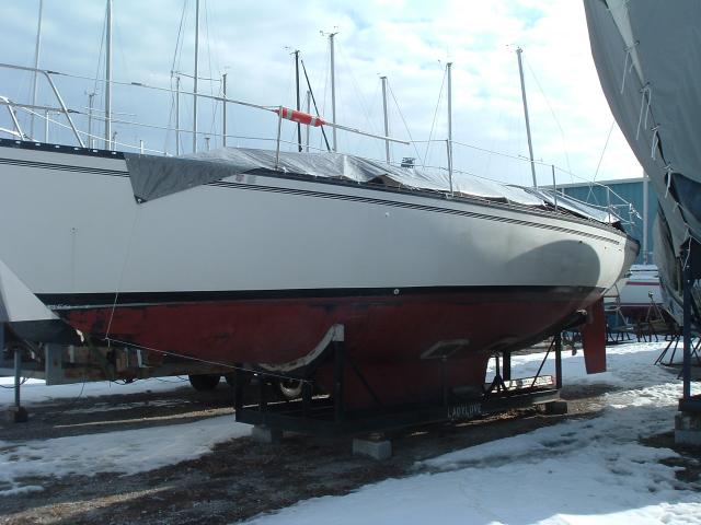

Tomorrow morning I have contracted to have my keel cleaned to bare lead. Years of modified-epoxy paint buildup are beginning to peel off in places. I hesitate to tell you how much they charge an hour. Has anyone seen soda blasting done? How long will it take to do my keel(pictured).
Another reason for asking is that I wonder how long it would take to do the entire bottom down to the barrier-coat. A few years ago I switched to an ablative. Now I think it might be nice to start over. Or should I worry that soda blasting will damage the barrier-coat?
P.S. I did call and was told they won't know until they see it. And I cannot be there.

But "what does "fast, fast, fast" mean? How long to do that keel? Or maybe "it depends", like how many coats and how hard.

Called that pretty close Phil. Looks like four hours for the entire bottom at $150. per hour. He called and quoted $600. He found the keel was coming clean with some difficulty. Can't wait until Thursday when I can go and see the result. I hate having anyone work on my boat, especially when I am not there. But this year it is the only way. Next is to get quote for wash and wax.

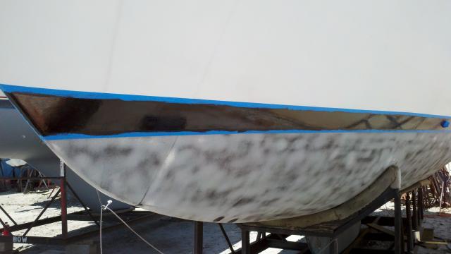

Well today I got to see the results of soda blasting the bottom and keel. I was pleasantly surprised. Might have been worth that big check I wrote. You can see that a little black(original antifouling) remains on the barrier-coat. But better than going through to the gelcoat I think. The keel is much smoother than I thought it would be, just four or five scarred sections to fair. I think I can recommend the process.
