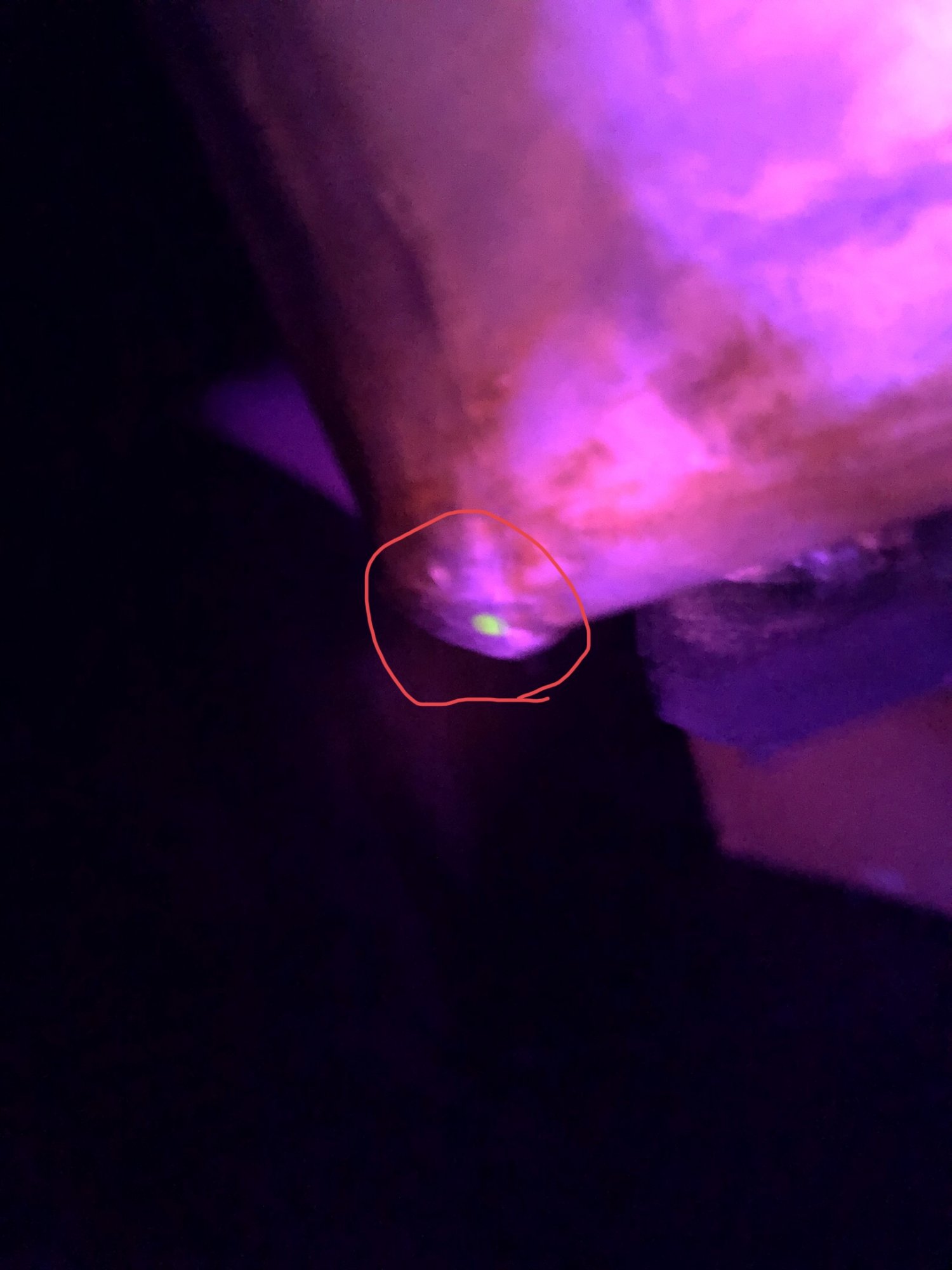

I was able to confirm the suspect leak with dye under black light (green dot inside the red drawn circle). It’s coming from the welded joint at the deepest forward port bottom corner.
Putting a screw here doesn’t seem like it would work well as it would just create more fractures in the joint corner. What about using a polysulfide or polyurethane sealant or just epoxy on inside and out? I also planning to talk to a welder to see if it’s possible to just fabricate a new forward side, remove the old one and re-weld the new one with a new joint.
I once brought this very idea up with a local tank welder. He said repairs are possible, but very tricky. He said that it's tough to grind the old metal clean enough for a good bond. Often he was able to make such a repair OK, but sometimes it would fail in some small place, later. I got the message that the tank would have to be cut back far enough to be completely away from any pitted or compromised metal.
The advice was generally to replace a 30 or 40+ year old tank with a new one. After decades, the old tank does not owe you anything, in any case. :)
You did not ask, but when I needed a better tank, I sourced a beautifully-fabricated new tank from https://coastlinemarinetanks.com/
I was able to have a new one built with a baffle, two large clean-out ports, and a new sender for an electric gauge. Every fitting was right where I wanted, the the metal was thicker than the original one, also. Since the OEM tank left some unused space where it was installed I was able, working from my own new mockup, to have the new one built with considerable more capacity as well.
If you can get the tank out, then it's a simple, and reasonably inexpensive job, to have a regular machine or welding shop to fix your leak. Most of my leaky tanks have been on a delivery or a vessel that must be back in service the next day.
NO. Many years as a chemical engineer in the petrol business. None of those will work for this. The suggestions are for sealing sending units, for example, not this.
Epoxy rated for this service, inside and out. Super clean, well-sanded surface extending beyond the repair.
