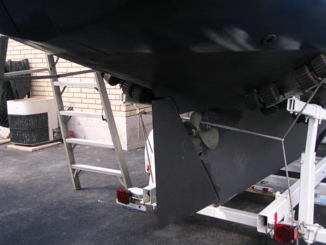

Well, I've been busy this week.....I finally gave in and took the boat to a Marine shop (insurance claim) to get the prop, shaft and rudder done. At first glance the Pro thought for sure I was over propped too, but after confirming my engine and tranny setup, it appears I have a 3.1 ratio, and a 13LH12 is actually a bit under propped for my set up....specs call for a 15LH10, but apparently by dropping 2" in diameter, and increasing 2 for pitch equals "almost" the same performance. I knew the prop was slightly damaged, but the shaft DID turn out to be bent too, so new shaft coming as well as prop repair...they did remove the rudder to accomplish all this, and I've been told it was rather easy, and that they WILL show me how to do it myself when I pick the boat up...I will pass on the info when I've got it
