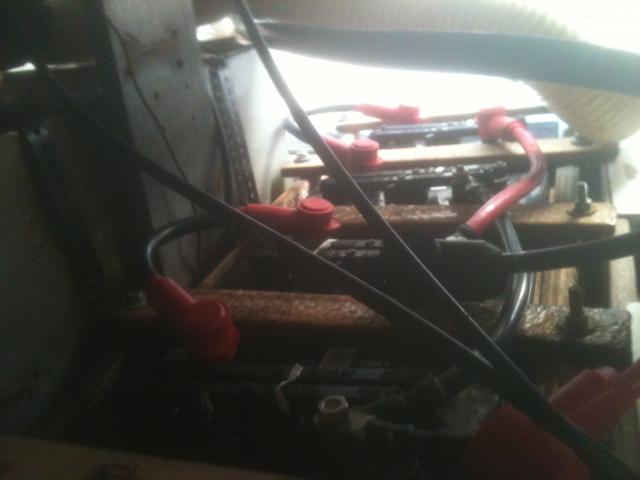

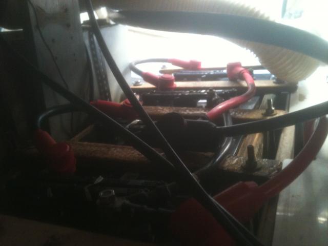

These pictures show the battery box that a PO installed. He did a nice job. The batteries fit tightly along with a few shims and they are held in place from the top by wood strips. The entire case and wood strips have been covered in resin as well. There is pretty good access to the shaft and hose. I don't have pictures of that area but the next time I'm at the boat, I'll take a few.
