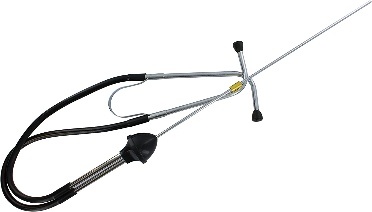

I like the water/bubbles test. Mechanics often use an improvised stethoscope combined with visual and smell inspection.
