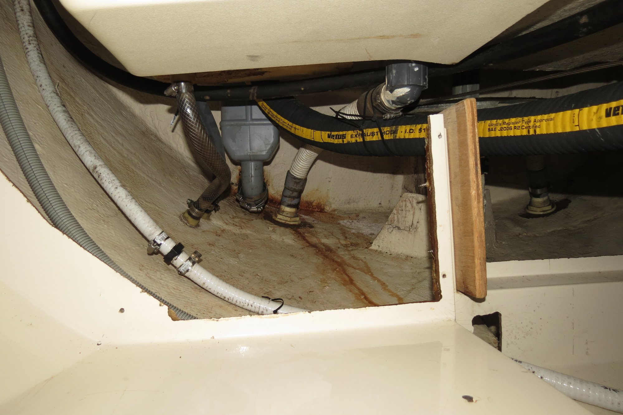

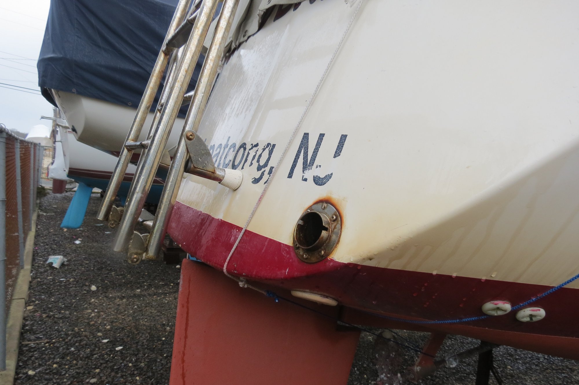

I've had a persistent leak at the exhaust since I installed our new engine several years ago. It isn't a major leak, just enough to cause a little water in the bilge while underway. It's been a long time since I removed the back panels to look at it. Now I'm wondering how to go about curing it. Is it possible without removing the exhaust fitting at the stern?
The stern fitting is a 2" SS assembly from Vetus. Originally, there was a 1-1/2" fiberglass tube that the hose connected directly to. With the new engine, I needed a 2" muffler so I had to drill out the original hole and insert the stern fitting. VETUS stainless steel transom exhaust connection, check valve, 51 mm - Transom exhaust connections - Exhaust systems I had the installer do the work. Some remnant of the original tube is left as can be seen above the exhaust hose. I can't remove the hose because the muffler is locked in place and so is the Vetus flange. I can't tell if the water leaks from around the outside flange and thru the new drilled hole, or if the water leaks from the hose. The hose is double clamped, so I doubt it is the issue.
I think the orangish stains are from the leaking water. There reddish material around the cockpit drain was there before, I'm pretty sure. The same stuff is around the one on the other side, too. I couldn't get the cockpit drain off by hand so I left it unclamped for now.

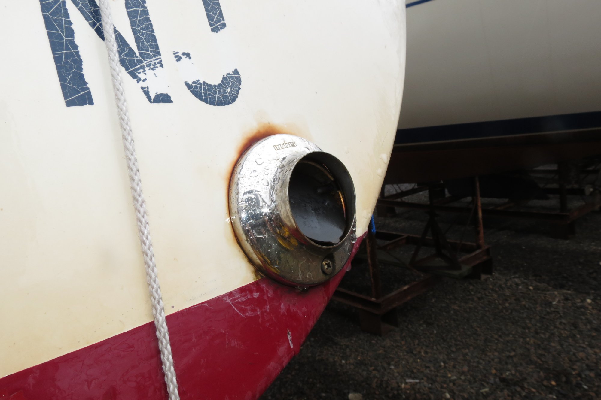

Well, I did have some concern about the other thru-hulls that are in that vicinity because they are all virtually submerged when the boat is running. If you look at the photo underneath from further back, it is pretty evident that the water comes from the exhaust port. The 2 cockpit drains appear to have some sort of red sealant that was used and I don't see any sign of a water trace from the port side. There doesn't appear to be anything coming from the locker drain or the bilge discharge either. I only get water entering when the engine is running, which makes sense anyway because all of those thru-hulls are above waterline when the boat is just sitting in the water.
If I had enough patience, I suppose I might try running the engine at the dock and watch for a leak while the boat isn't moving. But that would mean waiting for several months :banghead:I think that the logical course of action is to remove the Vetus fitting and make sure it is well bedded when putting it back together. My fear is that I can't crawl in there and get my hands on all of those parts with enough strength to get everything apart and then back together. Plus, I have no idea how they got that muffler in that space and I'm afraid that I will need to move it to remove the exhaust hose.

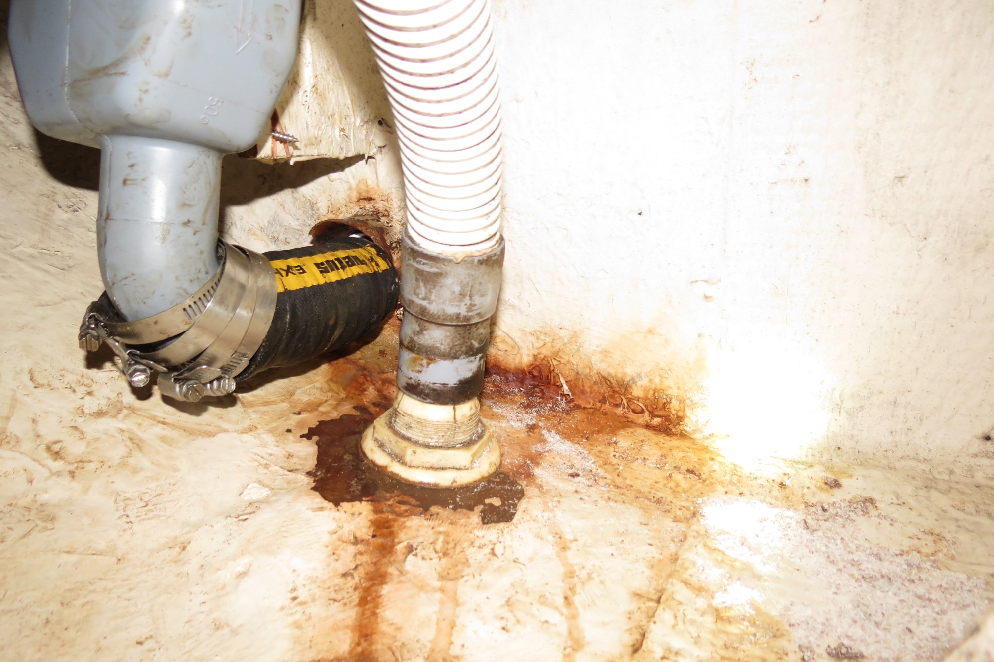

I don't think the darker red color is staining from water intrusion. There is the same material around the other cockpit drain on the port side and it doesn't show the tracing of a water leak. It looks more like a sealant material. The lighter rust stain is the tracings from water and it originates at the exhaust port. It just happens to flow around the cockpit drain on the starboard side. and you can see it also further towards the center.
All of those thru-hulls, including the cockpit drains, are above waterline when the boat is still. They are below WL when the boat is squatting while underway.

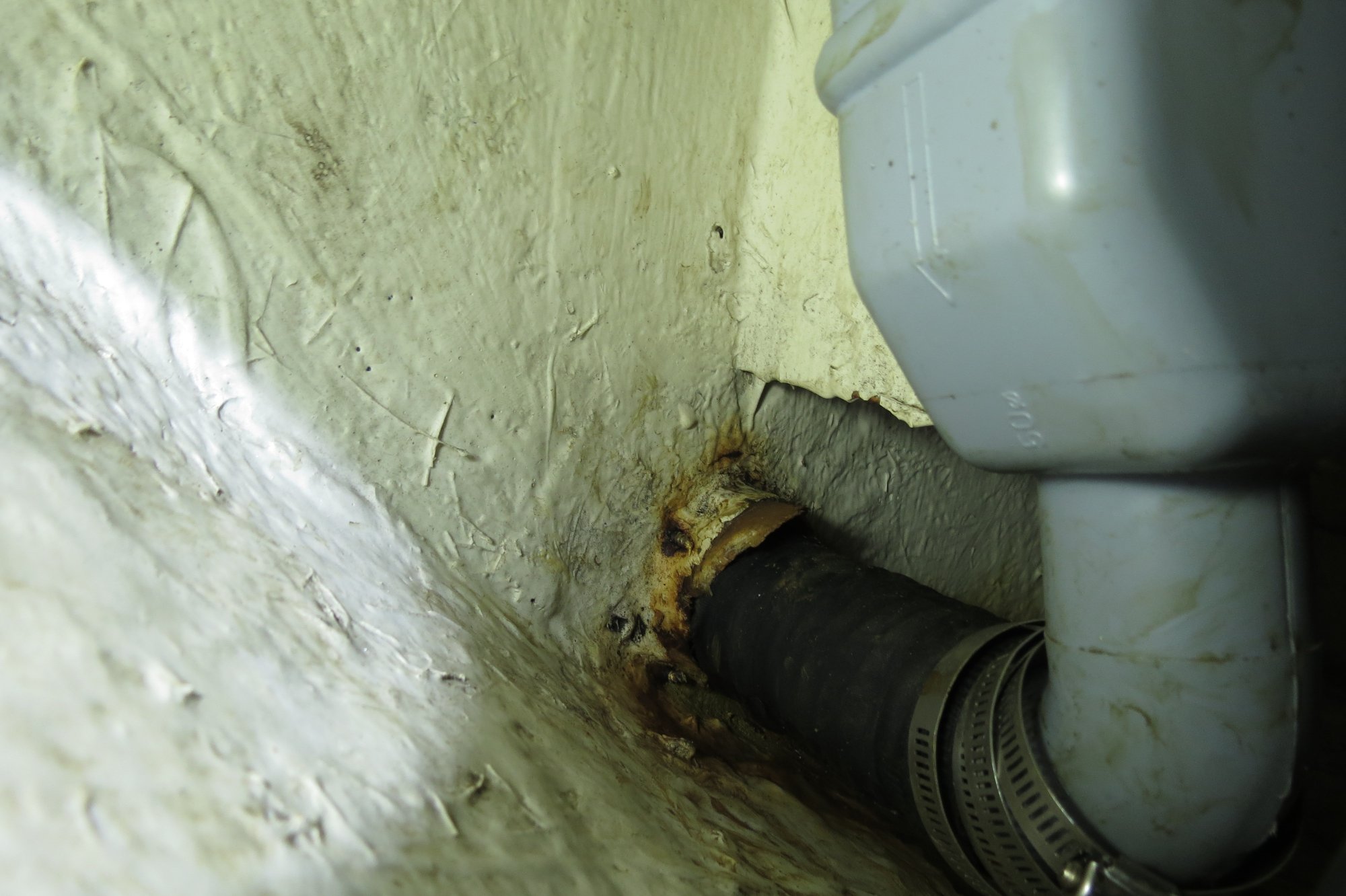

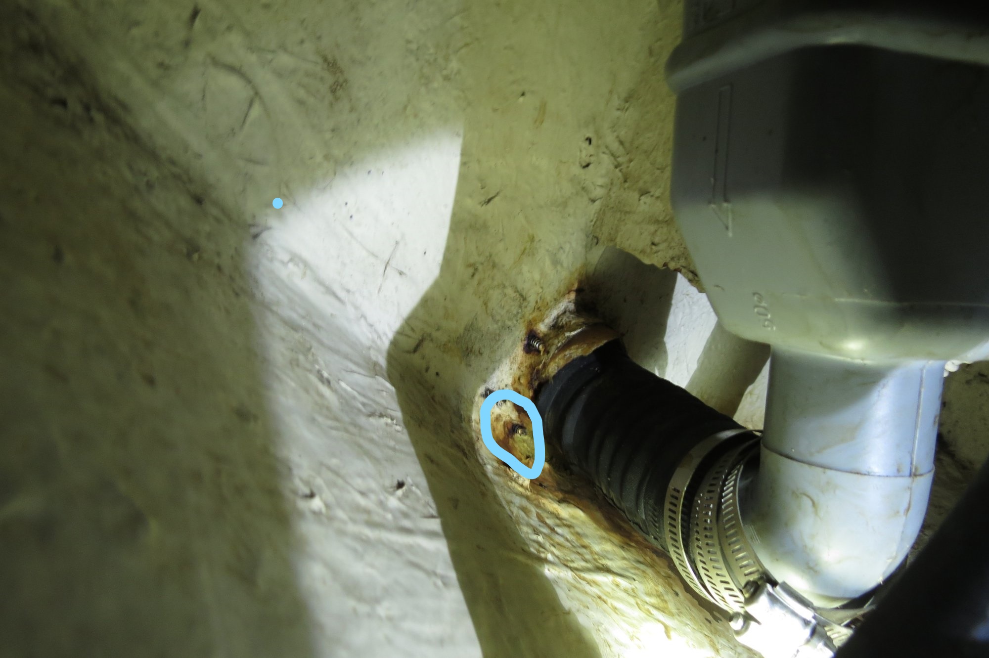

Looks to me at least some of that leakage is coming in through the bottom left hand screw (looking from the inside back to the transom) where the stain is kinda like a dark river, that screw is very corroded as well.
Good eye! I think there may be leakage at each of those screws. I could try to replace them with machine screws and nuts, but it doesn't look like I will have a flat surface on the upper ones unless I remove the fitting and cut away the remnants of the old tube.

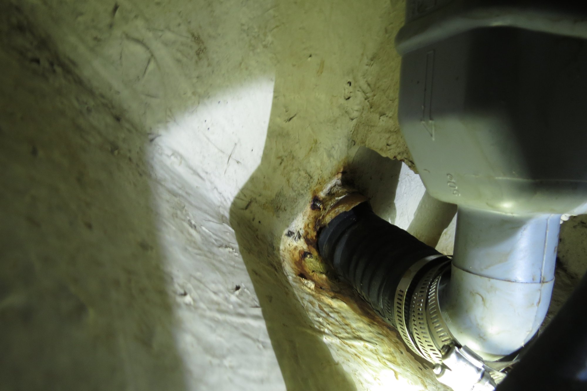

here is another look with a better angle to see the top screw without shadow. I think there is some dark staining around that one as well.

Great photos, Scott! That makes it easy to see the situation. I don't think you have an leak from the exhaust hose connection. Wouldn't there be some carbon staining as well? Rust is insidious and tends to collect and grow in places like that where you can't clean it off. Could just be condensation working on the fasteners, clamps and stuff (no leak at all).
My 2 cents: Your exhaust outlet is secured with machine screws. Good! Take it off, clean it up, re-bed it and re-install(new screws). Then you can connect your exhaust hose back up, clamp (new clamps if they're rusty), unless you see a problem.

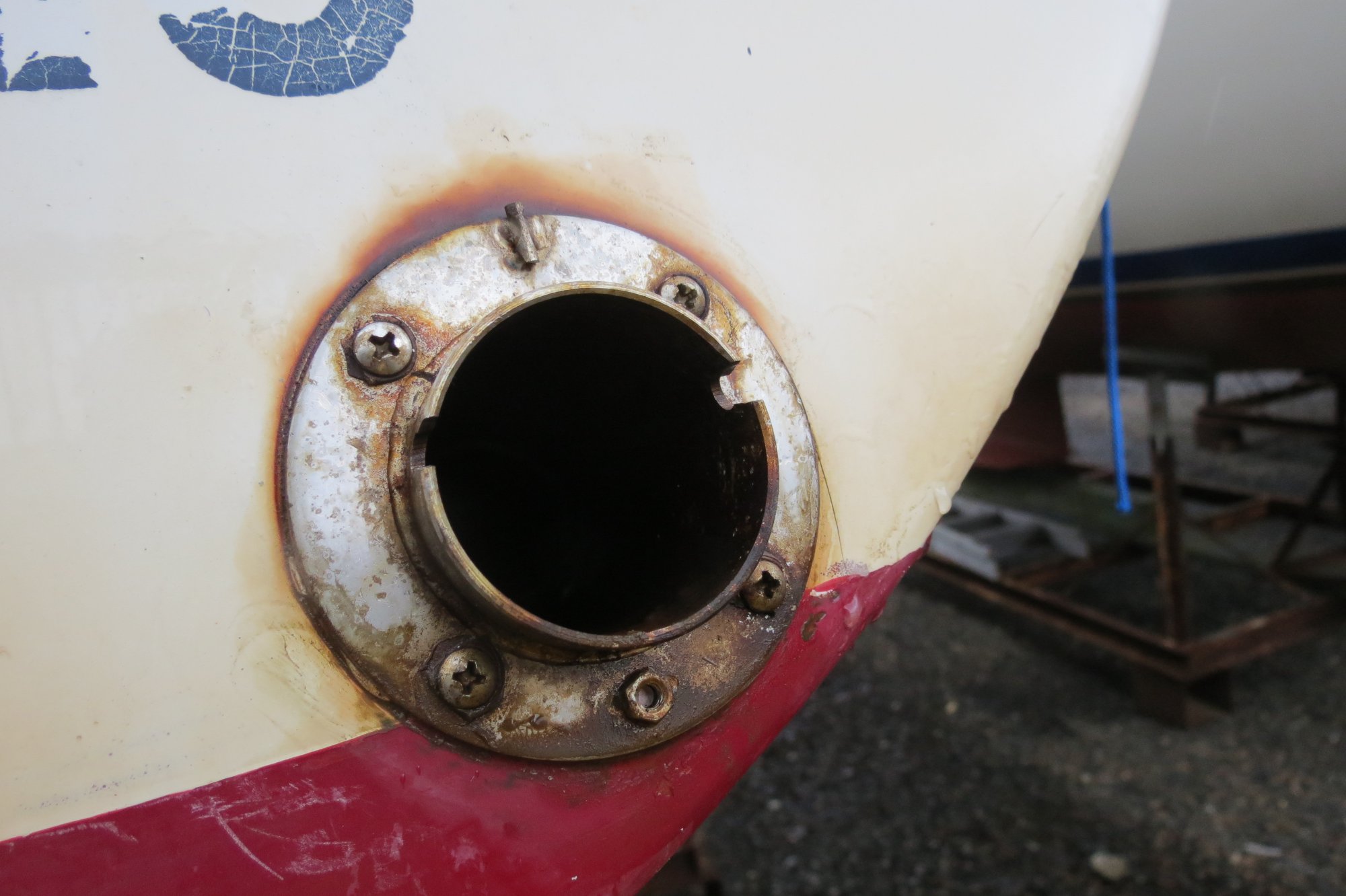

Sorry if im repeating what you already know- If the flange and screws are stainless it looks like you need to rebed that flange and the screws, water is getting in. Remember stainless will rust if not exposed to oxygen; so poor seal, water gets in, no air and that makes rust that bleeds out around the screws. I'd follow TomY's advice. Good luck let us know how it turns out.
