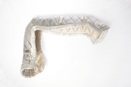

M-25XP in my Cat 30 ; Insulation is breaking down spreading gray dust throughout the engine compartment.....thinking Asbestos. Wrapped it once but not holding.
