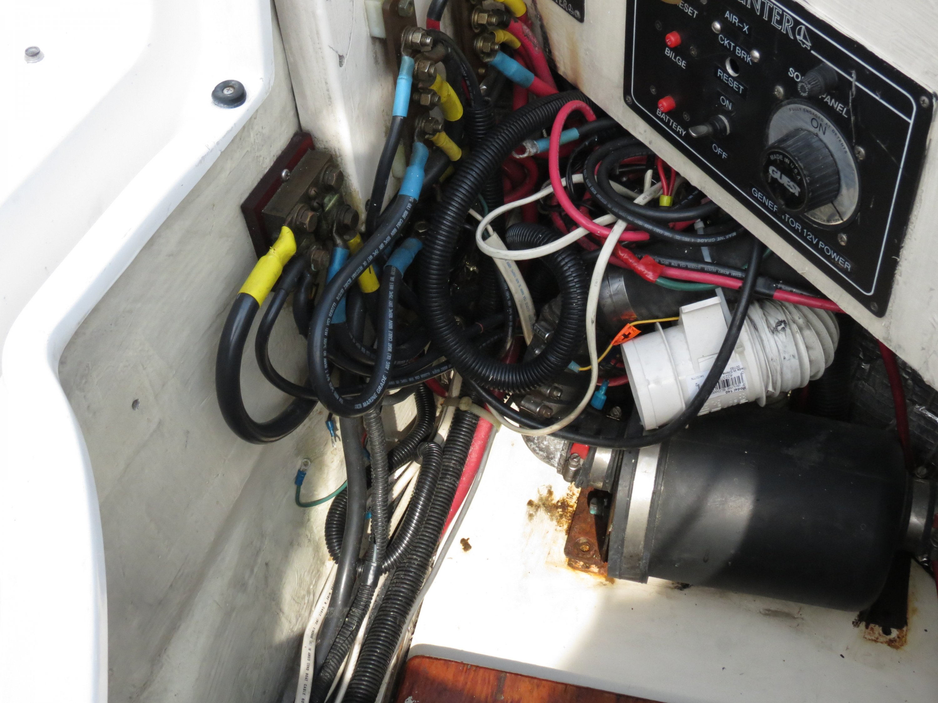

I use a standard 3" in-line bilge blower. My genset needs electrical end air cooling and this works for me. Have you actually measured the compartment temp? We have hot days into the 90's when I run the generator for air conditioning too. See the white blower that I connected to the flow-thru air port on the transom. I sealed off the connection to the aft cabin.
