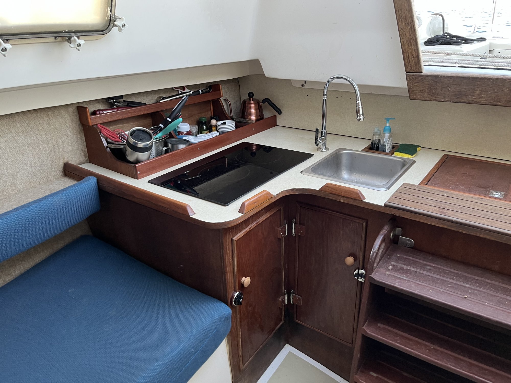

When I discovered I had excess capacity in my 400W / 7kWh system (for my electric outboard), I installed an inverter and an induction cook top...
