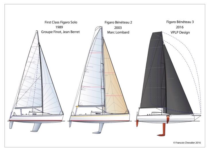

Neat picture of the evolution of the Figaro short handed offshore race boat. While the length is the same, the rig has become both simpler and more powerful. Also of interest is the huge increase in hydrodynamic lift and righting moment, even while the surface area of the keel has gone down. What else do you see as changes?
