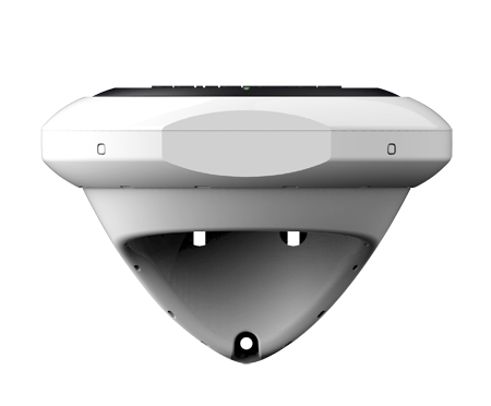

Knowing what to look for helps...
The EV1 Sensor Core
The Computer (Actuator Control Unit)
Here is the Type 1 Mechanical Linear (12V)

if you have rudder position indicator follow the wire to the ACU from there you'll can follow the nmea 2000 line to the Sensor Core

Old school AP would have a flux gate tied into the ST60 now the EV-1 has P70 head that has nmea 2000 to the ACU also the wheel drive motor is also tied into the ACU.
