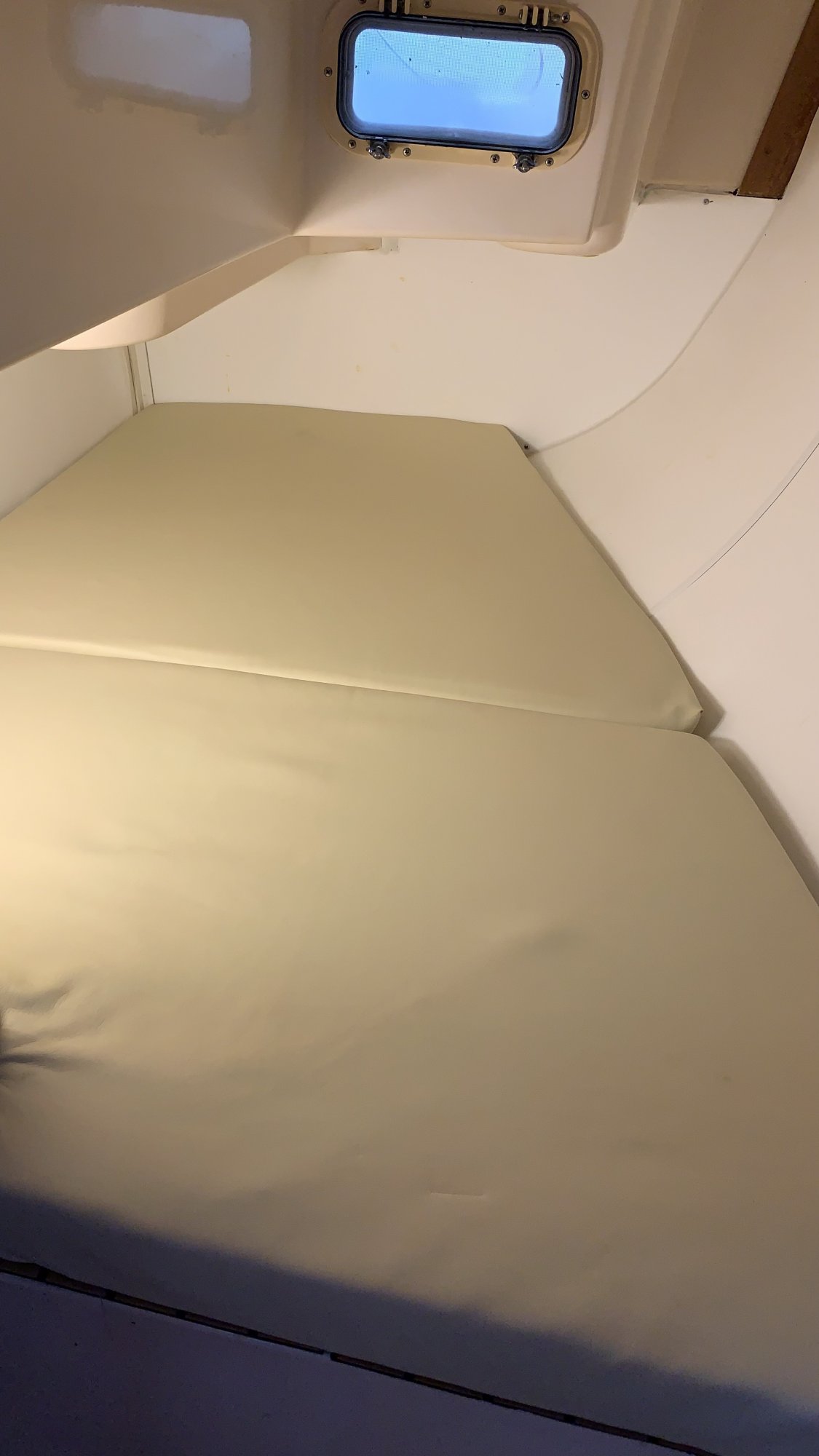

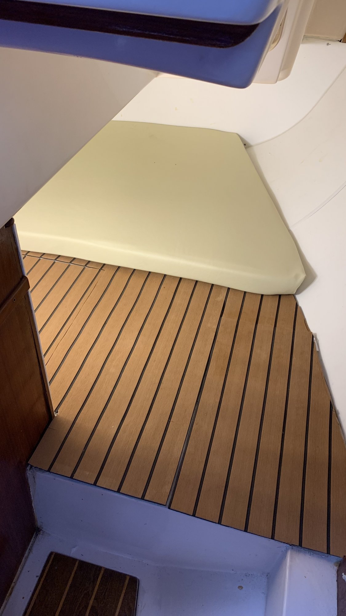

Here is a closeup of the aft cabin with one of the cushions out. Also the Sea Ray with the machine cut EVA foam teak and holly with finished edges. I could never reproduce those edges as they are CNC cut.

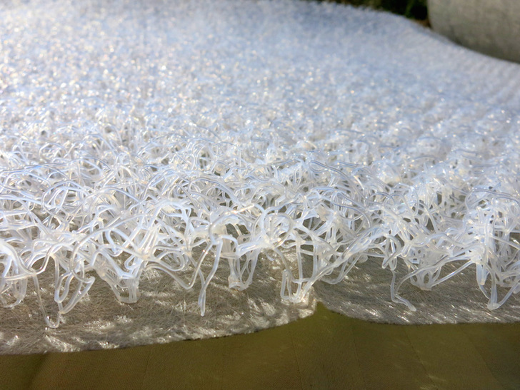

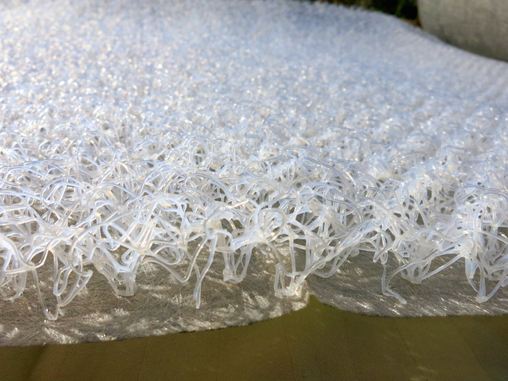

Regarding the base for your V berths, I am thinking the EVA foam would provide an insulated base. The moisture from two hot bodies on the foam may trap moisture in the foam. There are two products I have seen that raise the cushion off the base leaving a 1” air gap between cushion and base. This air gap solved the moisture issue for me.
I used a product called HyperVent. Genuine Hypervent Fights Condensation

Originally when I acquired this boat the product underneath the cushions was this or similar mesh looking fabric which was mildewed, black, and smelly along with underneath the cushions. Tossed it all and started from scratch with new fabric upholstery and then later the Ultraleather which prevents any moisture to penetrate into the foam, plus Ultraleather is known as the best material to prevent sweating which is why the aircraft companies use it for pilot seats and now yacht manufactures are exclusively using it in their cabins. We don’t sleep anymore on the sailboat since we do day sails and only the grandchildren use the v-berth and aft cabin to play.
