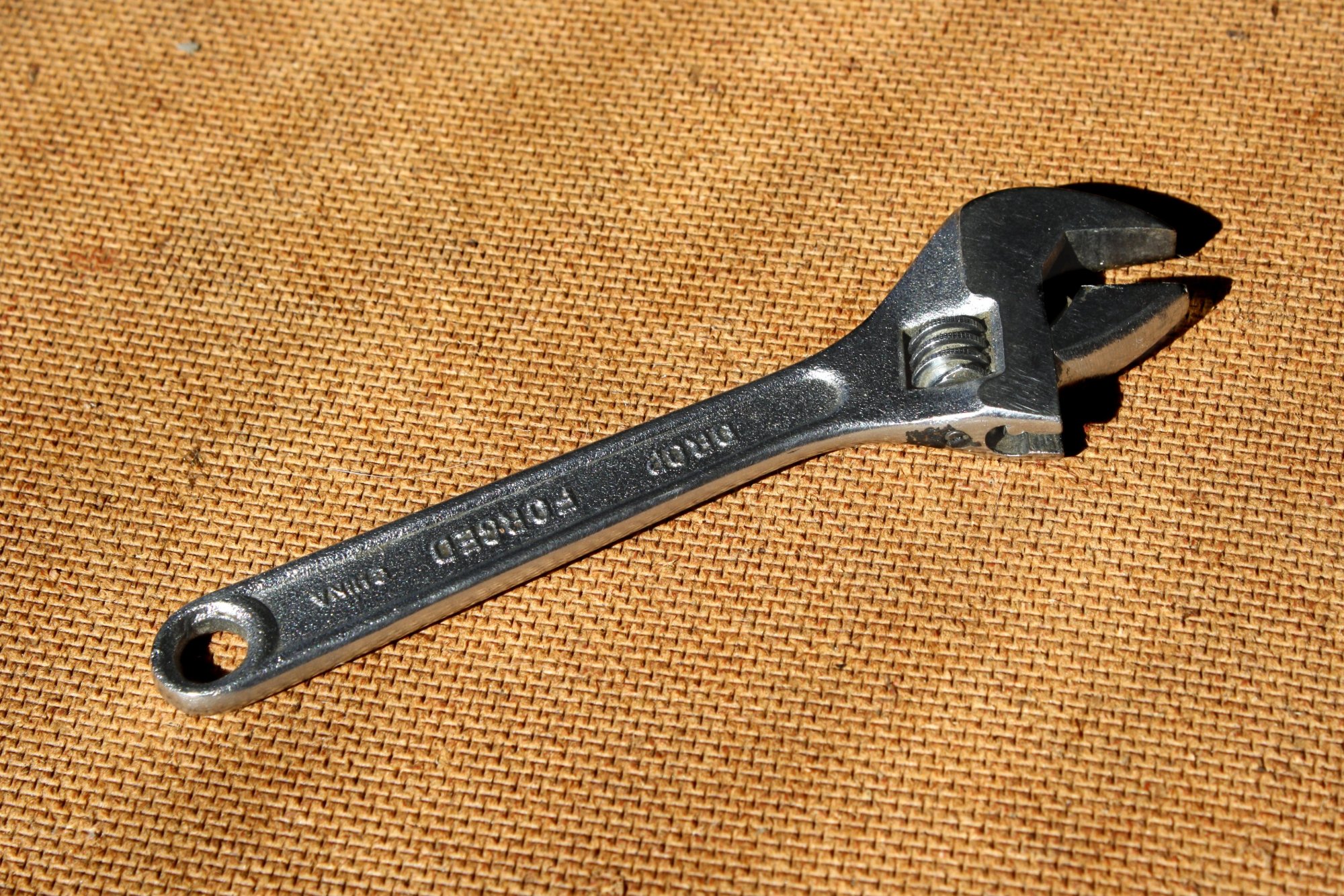

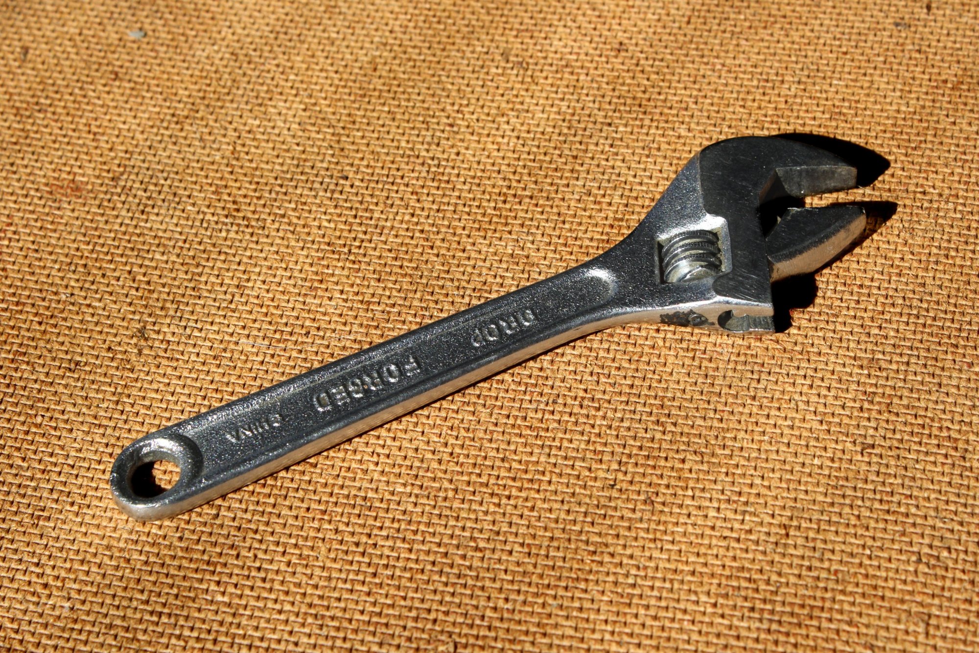

I am particularly fond of my metric adjustable spanner, loaned to me by my friend @LeslieTroyer the engineer.
It is a British design.
He said it will work on my Perkins British engine.
