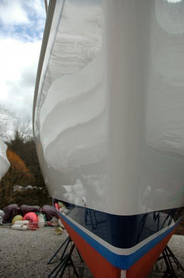

One insider secret is that less distortion in the reflection shows a very good polish/glaze with virtually no swirl marks. If the items in a reflection, such as a ladder, seem distorted the polishing is not up to par. You can also hold a ruler at 90 degrees to the surface and see how far you can read it. The further you can read the numbers the smoother the surface.
The straight on reflection is always the toughest, off angle shine is easy in comparison. This was a navy blue cove stripe on a badly oxidized mid 80's Ericson.

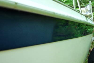

Before & During: This picture shows just how badly oxidized the cove stripe was. This is only after compounding. There was a polishing phase done after this.
Remember to keep the pad flat!
