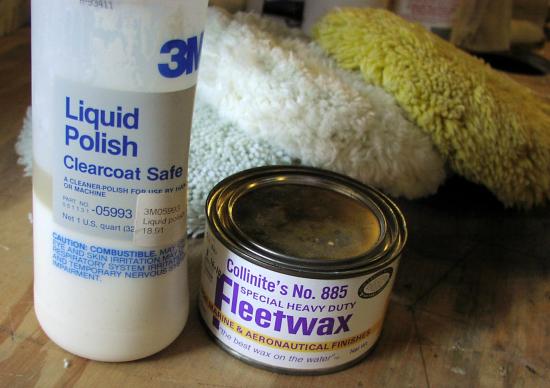

#2)Buffing Pads- You will need two or three grades of buffing pads or discs. I only recommend 3M pads because they are easy to find and most Napa Auto Parts stores stock them. The 3M heavy wool Hookit Superbuff pads are great for the compounding phase the part number is - 05711. For polishing the yellow wool Hookit polishing grade pad #05713 is another favorite. You can also use the 3M foam polishing grade pads like the #05725. They are wonderful for adding the finishing touch.
Use a heavy wool compounding grade pad for the compounding, and a polishing grade wool #05713 or the #05725 for the polishing stage and the same #05725 foam pad for the finishing or glazing stage.
I’ll use 3M professional grade foam pads #05725 for the polish & glaze stage but I also use some Lake Country CCS pads. When buffing a gelcoat hull it’s important to match the aggressiveness of the pad to the phase of the buffing though you can experiment too and have great results. You will just not get a good final shine using a heavy compounding grade pad even if you’re using Finesse It or Chroma 1500 with it as the wool itself is too course.
#3) Microfiber Rags- Honestly these are the best invention for buffing & waxing since the buffing machine. I’ve been using microfibers for years and years on antique cars and trust me they have come way, way down in price since their introduction.
A pack of three microfiber rags used to cost me in the vicinity of $40.00 but now you can buy a pack of three at an auto parts store or, gulp, even Wal*Mart, for about $3.00-$4.00. Occasionally Sam’s Club will have them in 18 or 24 packs for about $12.00. When buying microfiber rags be very wary & conscious of the quality. A good rag will look more like a good quality terry cloth towel, with thick full loops. In short, it will be nice and robust and the quality will be visible to the naked eye. Even the worst quality microfiber rags will still outperform the best quality terry cloth so don’t worry too much. Again, these rags are amazing and they will save you time! Trying to compare terry cloth or cotton rags to microfiber rags, for this job, is like pairing Michael Moore & Bode Miller in a ski race. There is NO comparison..
#4) Wet Sand Paper- Usually any good quality wet-sand paper like 3M is fine and grits of 600-1000+ are what will be necessary. If your hull does not need a wet sanding don’t bother buying it. You can actually wet sand the entire project then after 2000+ simply do a polish phase but this can be a LOT of work.
#5) Compounds- All compounds & polishes are not created equally. Avoid buying any compound that uses terms like “essential oils” or has the word “silicone” in the label. Compounds with these additives are intended for novices. Unfortunately, these products, like 95% of the “one step” products will give a false & premature shine. This premature shine is caused by the “essential oils” or “silicone” & will cause you to stop polishing before you’ve actually polished anything due to this false shine. They add these lubricants to the product to make the wheel spin easier and to make you think you are getting a great shine. Sadly the shine is fake, premature and caused by "essential oils or silicones"
Perhaps the best, of the easily available compounds, is 3M Marine Rubbing Compound. I’ve used it with very good success over the years and it works. Is it the best compound? No not at all. Do I regularly use it when compounding? No, but I still do on occasion. 3M Marine Super Duty Rubbing Compound is a good product and it would be considered “paint shop safe” meaning it contains no “cheater oils” like silicone.
If you want very, very good products look up Presta Products on-line. Presta Gelcoat Compound is a GREAT compound that leaves a surprisingly high level of shine before you begin to polish. Presta is generally sold only through body shop distributors and are water based (zero oils), but also worth every penny. For the average guy who just wants his boat shiny 3M is decent. If you’re part of the anal-retentive crowd, who will settle for nothing but the best, do yourself a favor and look into Presta Products it's basically all I use these days and it performs well above the 3M stuff.
#6) Polish- After the compounding phase you’ll need to polish. 3M Finesse It II is a good choice for a polish. I’ve used many bottles of Finesse It II and it’s readily available and “paint shop safe”. Unfortunately, Finesse It II does have some chemical binders or carriers in it that give a minimal pre-mature shine. A quick wipe down with a spray bottle of denatured alcohol and a rag gets rid of this so you can see the real shine you’ve created.
Again, for the next level Presta Ultra Cuttting Creme with the yellow wool #05713 pad is a great step to follow the Gelcoat Compound with. It is my #1 choice for both light compounding and polishing. This unique product, like all the Presta compounds and polishes, uses a very high quality diminishing grit media that starts out more aggressive than Finesse It II but finishes finer than it thus avoiding another full step.

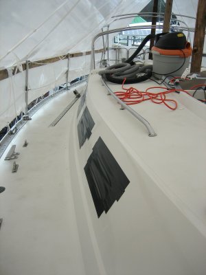

Cleaning the hull:
Before wet sanding or compounding can begin you should thoroughly clean the hull. For this process you’ll need a cheap rain suit, duck tape, rubber gloves and some ON & OFF, On & OFF Gel or FSR gel (basically acid). Duck tape where the gloves meet the raincoat so you don't get acid on your skin while reaching over-head to wash the boat. I find using On & Off, and a car wash brush, as effective, but far quicker, than applying FSR gel and they are both made of the same basic components (acids).
Buy a roll or sheet of plastic and rip it with a razor knife into 12-inch wide lengths. Tape this to your dry hull surface at the water line using 3M green film tape (seems to work) at the top but let it hang on the bottom as a “drip edge” skirt. You do this so the acid in the ON & OFF does not eat the copper bottom paint and can drip on the ground vs. the bottom paint. Wash and rinse quickly a small area at a time and do this preferably before you before you bottom paint just in case. On & Off is basically FSR without the gel. However, you can wash much faster with ON & OFF than you can with FSR. The ON & OFF will bring back the white of the hull by removing the metals or tannins. Tannins are that rusty orange discoloration you get from the ocean over time that attach to the gelcoat. You'll be amazed at the difference in the color of your hull! Even hulls that don’t look bad look amazing after a thorough washing with On & Off. This is a very good place to start before waxing if your boat is older than a few years. Be very careful not to get On & Off or FSR on aluminum rub rails, metals, stanchions, cleats etc. because it will pit them. Only apply FSR or On & Off to a gelcoat hull! Allow about 20 minutes for the skirt set up and 1/2 hour for washing the hull.

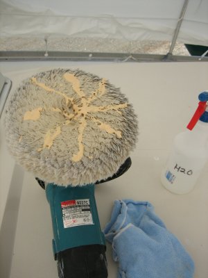

When compounding do keep in mind that a compound is like liquid wet sand paper. Therefore, you should keep your pad damp at all times. I use a misting bottle filled with water for this but don't over do it. If you are getting lots of small dot "sling" the pad is to wet. If you are a novice I do not advise attempting to use the buffer to "dry buff" or to "buff off" compounds or polishes. Running the pad dry, as in buffing until the compound is off the hull, is something best left for PROFESSIONALS or until you have the confidence and skill to go there. You can very easily damage your hull if you are not experienced at "dry" buffing. I've seen burned and permanently discolored gel coat from novices attempting this. This is part of the reason they put Silicone's in compounds and it's because most people don't understand the concept of how to use a buffer.
As a beginner your buffer should be considered just that a buffer and not a "remover". Work a 2 foot by 2 foot area first going at a slow speed 600 then slowly up to 1000 for 30-45 seconds then turn the dial up to 2k+ but below 3k and stop before it is dry. Next wipe the residue off while it's still in the "damp haze" mode. Don't let it dry or it will be a bear to remove unless you wet it again.. This will show you how much more you need to do or if you can move onto the next 2X2 area. ALWAYS, ALWAYS keep the pad and machine moving!!!
Apply compound in a criss-cross not a circle (note the mist bottle of water):

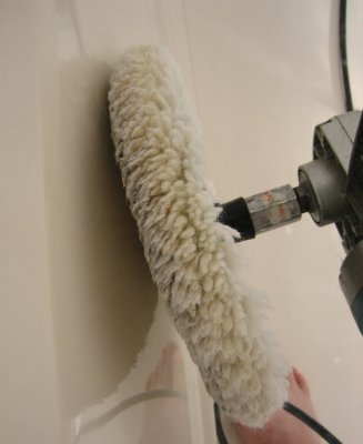

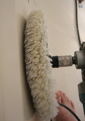

Edging the pad is for pro's or after you get comfortable with the process & machine !!
Right Way - keep it FLAT..

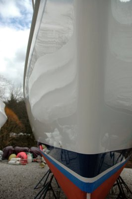

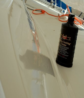

After compounding phase only using Presta Ultra Cutting Creme (no sanding was done here 30 year old gelcoat):

When buffing & waxing a boat, out of the water, a good trick is to cover the bottom paint with at least 2" blue tape so you don't accidentally buff and wax the bottom paint. It's important to tape neatly so you get wax as close to the bottom paint as you can without actually getting it on the bottom paint. I usually do a 3/4-inch width tape followed by a 2-inch width giving me plenty of tape to save my buffing pads. Fouling of your buffing pad, with bottom paint, is the end of that pad until you can wash it in a commercial washing machine. To keep "sling", what happens when you use a rotary buffer, and it throws white dots of compound up onto your deck, off the decks, I bring old card board boxes to the boat yard. Lay them on the deck directly above the area you're working protruding about 12" over the edge of the deck. The cardboard overhang will catch any "sling" on the way up and it will save you huge amounts of time cleaning white dots off the surface of your deck!
Blue Tape:
Tips for keeping it clean:

One insider secret is that less distortion in the reflection shows a very good polish/glaze with virtually no swirl marks. If the items in a reflection, such as a ladder, seems distorted the polishing is not up to par. You can also hold a ruler at 90 degrees to the surface and see how far you can read it. The further you can read the numbers the smoother the surface.

As for maintaining the wool buffing pads I wash them alone on COLD with Woolite in a home front load washing machine. Sometimes it may take two cycles to get them clean. Please do not dry them in a dryer and don't wash them on hot. They are wool and a hot wash or dry will literally change the pad grade. A polish grade pad can become a compound pad fairly quickly so wash cold then air dry. I rarely have to clean a pad, during a buffing project, unless I'm doing a boat that is badly oxidized. Use slow speeds and light pressure to prevent compound burning. You can also use a mist bottle of water, very sparingly, to give a little moisture to the hull and lube the pad. This however will create more sling so you’re best to go slow and keep the compound wetter. The secret is to keep the pad "damp" if it dries, it burns, and you'll need a "spur wheel" or spigot wash to field clean it. Spurs are available at an autobody supply shop or auto parts store but I really, really dislike them and find there is not much need for one at all.
A trick I use for a "field clean" of the pads is to remove the pad from the buffer and rinse it under a boatyard spigot scrubbing it with my fingers until it's clean or in a 5 gallon bucket filled about 1/3 with fresh clean water. I then re-install the pad on the buffer and spin it on the buffers highest speed inside a 5-gallon bucket to catch the sling. Spin it until no more water spins off on the inside of the bucket. Once done with that use a towel to get it as close to dry as possible. This is the method I use as I feel it's much more thorough than a spur and does not make your pad black from metallic residue. With water based compounds a "field clean" is very easy!!
Field Clean - Wash:
Field Clean - Spin Dry:

Presta Products - Gelcoat Compound = Heavy compound but finishes with a deep shine
Presta Products - Ultra Cutting Creme = Starts medium/heavy but diminishes & finishes comparable to Finesse It II
Presta Products - Chroma = Glaze
If your boat is not to badly oxidized Ultra Cutting Creme with a 3M #05713 pad can get you there in just one step plus the wax..! This is my absolute favorite product for compounding / polishing.

Wax I use:
Collinite #885 Fleet Wax - Paste Version (Contains less than 2% silicone most of it's competitors contain 30% or more silicone)
