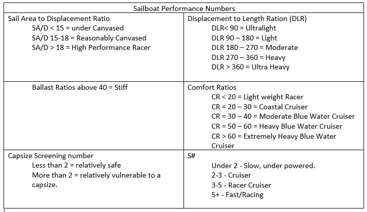

Here are some calculations related to your boat
And here is what they mean...
So your boat is reasonably canvased and should perform well under sail... i.e. faster than some boat in the 32 range...but her S# is less than 2 so that says just the opposite... YMMV. Her ballast ratio is above 40 so stiff (stiff is good). Displacement to length ratio is high so also good. Comfort ratio puts her in the coastal cruiser range... which means you could cross an ocean but you would be less comfortable than in some other boats. Her capsize screening ratio is below 2 so a relatively safe boat in harsh conditions.
All in all, I'd say you have a safe heavy cruiser that will sail as well as the next boat.
Enjoy:thumbup:

I got those numbers from sailboatdata.com
Here is the direct link to your boat
and here is what sailboadata.com says about the S#
S#:
S# first appeared (that we know of) in TellTales, April 1988, “On a Scale of One to Ten” by A.P. Brooks . The equation incorporates SA/Disp (100% fore triangle) and Disp/length ratios to create a guide to probable boat performance vs. other boats of comparable size. For boats of the same length, generally the higher the S#, the lower the PHRF.
So it has more to do with sail area and overall mass of the boat than horsepower. You have a heavy boat so it will take time to get up to full speed. But that same inertia will make the boat a lot more comfortable in chop and waves. Not a great choice if you are racing around the buoys and changing tacks every 20 minutes but not a problem (and a plus IMHO) on longer cruises where you stay on a set bearing for hours... YMMV
