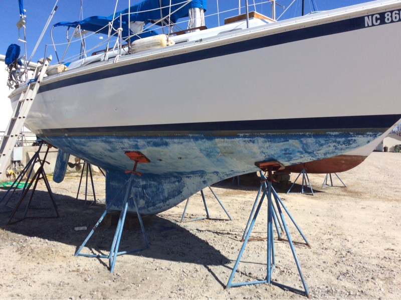

This is my Ericson getting some dirt time. I've always called this a shoal draft keel, but I guess that technically means a fin keel like Joe said.
Aug 16, 2006
281
Ericson 32 Oregon coast
A shoal draft fin keel. Often a manufactuer will offer
two variations, one a little shorter that is intended for shallower or shoal waters. The shape or style of the one depicted in your photo is a shoal draft variation of a fin keel.
