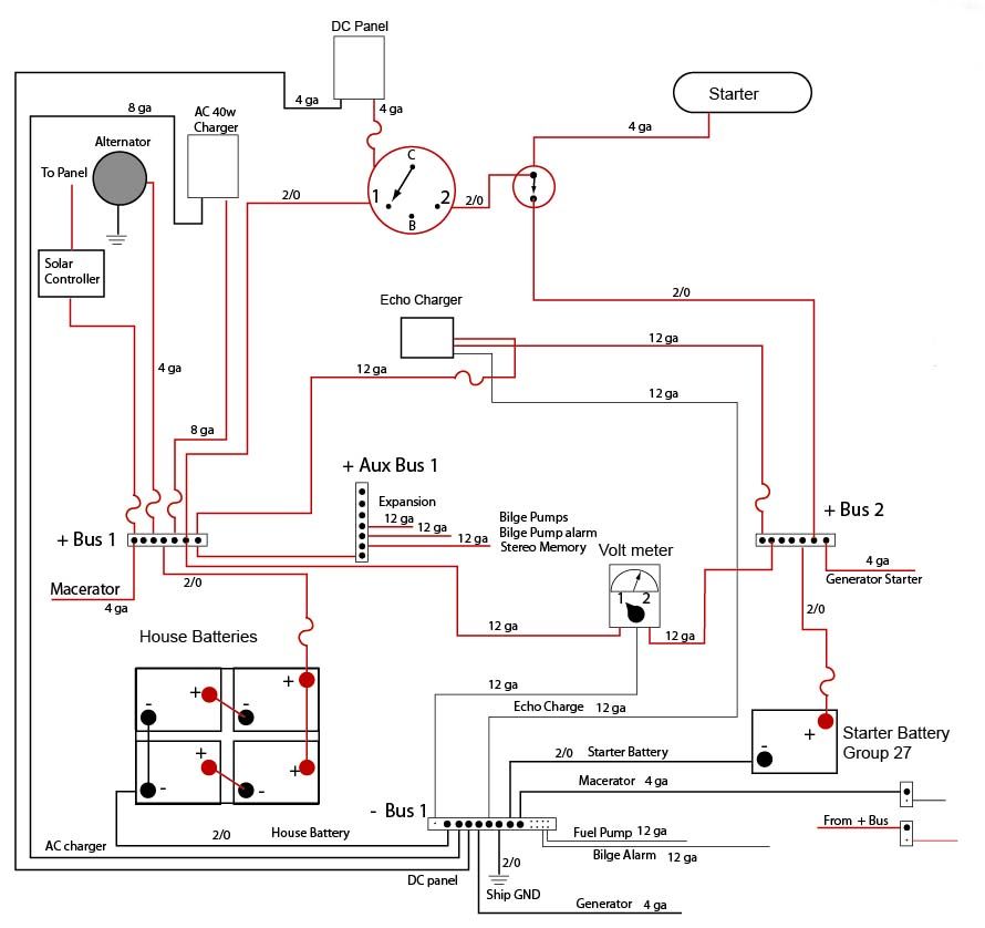

I've got a few questions on equalization and have searched, but can't figure it out.
First, here is what I have.
1. Xantrex echo charge
2. Four 232AH golf cart batteries (series/parallel for 464 ah at 12v total)
3. Statpower TrueCharge 40 with equalization button
4. start battery wired separate from house
Some of you might recognize this because a few weeks ago you helped me put together this diagram and I finally put it all together in the boat. It works beautifully. Thank you Stu, Maine, et.al. for all the help. This system was very easy to put together and seems easy to manage.
http://forums.sbo.sailboatowners.com/showthread.php?t=162139&#post1115226
I also read the manual for the TrueCharge, but it is not very clear, other than how to push the equalization button.
Here are my questions.
1. Do I disconnect the echo charge from the battery that is to be equalized?
2. Can I equalize all four golf cart batteries at once (keep them series/parallel wired) or do I have to break them apart?
3. How do I equalize the start battery if the out put of the TrueCharge only goes to the house bus? Do I move the TrueCharge output to the start bus?
4. I've read cautions that I should disconnect all loads to avoid damaging the devices. Is it sufficient to put battery switch in Off position and disconnect the "+ Aux Bus 1" (see diagram below)?
Thanks again.
OT: for those who noticed, yes, that is a voltmeter. Need to save up for the Balmar SmartGauge. Maybe Santa will bring it.
Shouldn't the positive from the 1-2-B switch to the Distribution Panel should be from the C post?
1. Take it off Bus 1
2. Yes, although MS suggests doing each battery (in your case a pair of 2) separately. Your boat, your choice.
3. That would be the easiest way
4. You don't need to do both. The reason is that the equalization voltages are above 15V, so you don't want any 12V loads connected to 15V. Since you understand how it's wired (good job!) then you should be able to answer that, right?
Don't do an eight hour equalization. Read MS's material, IIRC he suggests two hours, check then maybe two more.
Ventilate
Ventilate
Ventilate
Ventilate................................................:)
May 8, 2014
31
sailboat about 37' SE US
Yes, Stu, you are right about the DC panel coming off the C post. It is like that in reality, but I was sloppy in my diagram. Thanks for catching that and Thanks for confirming my answer to #4 ;)
