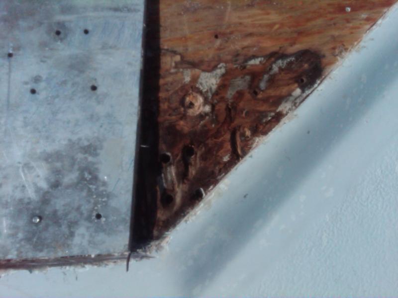

I tried the bent nail but gave up pretty quick. If I do it again, I would go buys a set of cheap allen wrenches and cut some off the business end and see what happens. Should hold in a drill chuck better. I tried to dry mine out with acetone and time, and when I eventually cut it open it was still wet. Guess I'm saying it is important do what you are saying patiently and right, I attached some pics of what I ended up doing which was cutting the whole area under the mast where it sort of raises up with a circular saw. About 1.5' x 2.5' area. Was a pain peeling it up but I got it off. After that, I sanded the inside of the surface piece I wanted to save, threw some fiberglass resin on it and replaced it with a few screws and a two tubes of the west systems epoxy in a tube, $20/tube. Added the old coins in there to. Have to pay the gods if I die at sea. The PDF is from a book I bought.
