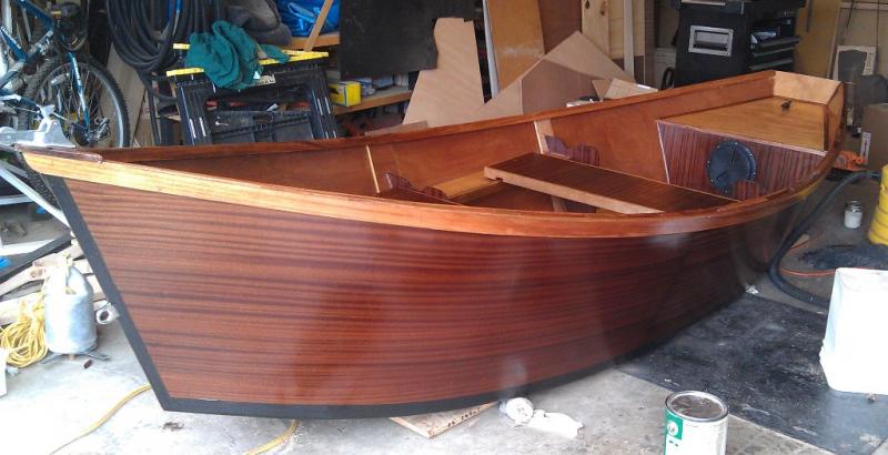

This was all epoxy resin. Used for the finish and for connecting surfaces. Even the fillets are thickened epoxy resin. The final outside coat was polyurethane for UV protection. It seems to hold up to river rocks. Ken
damn that's purty!
