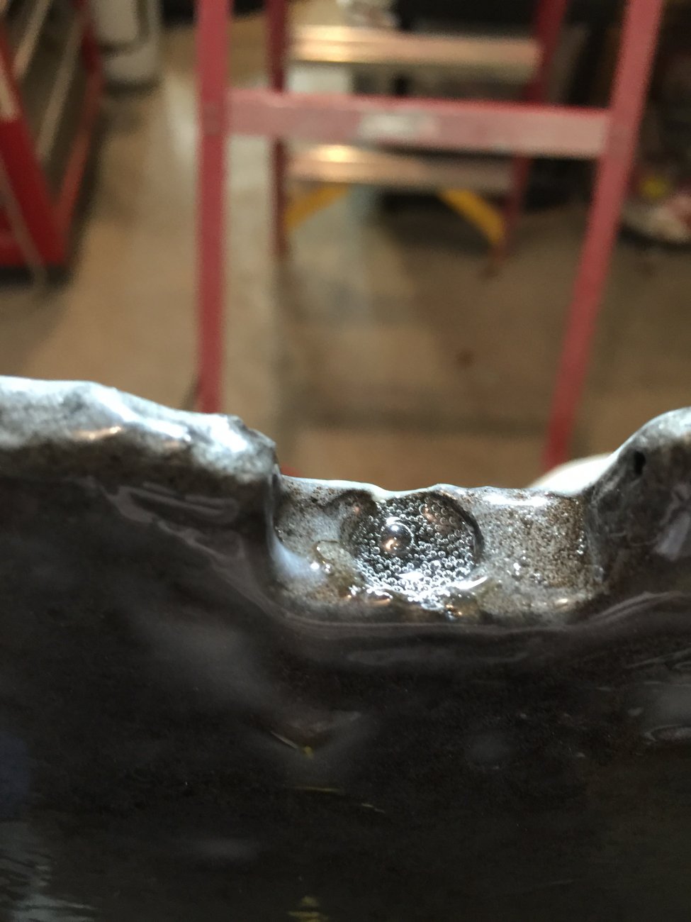

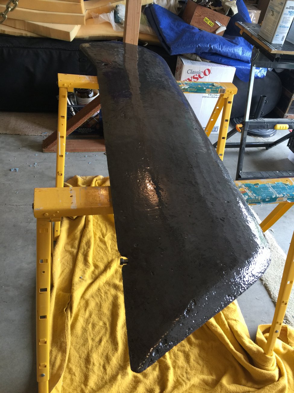

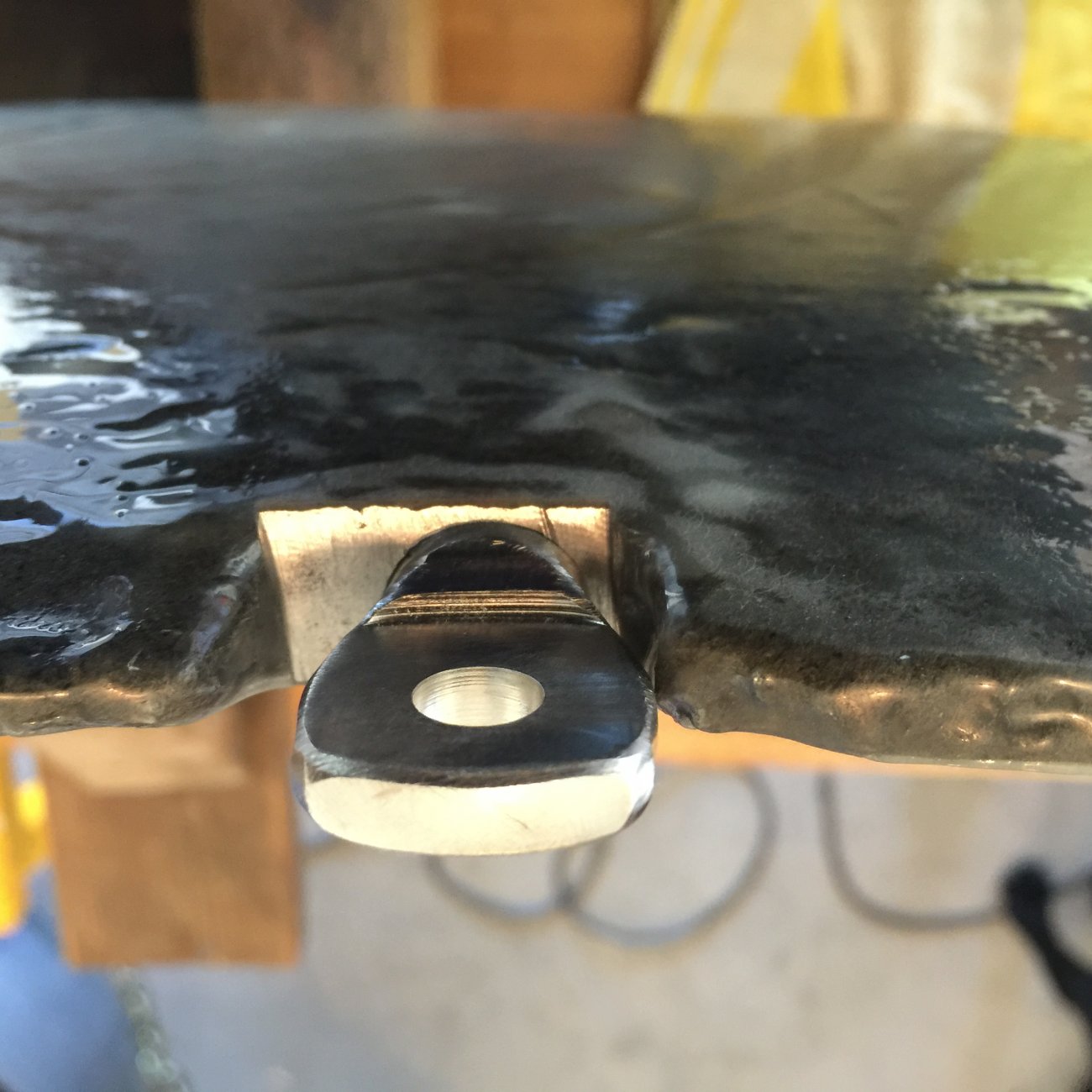

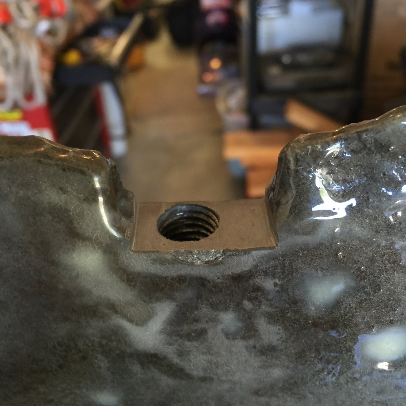

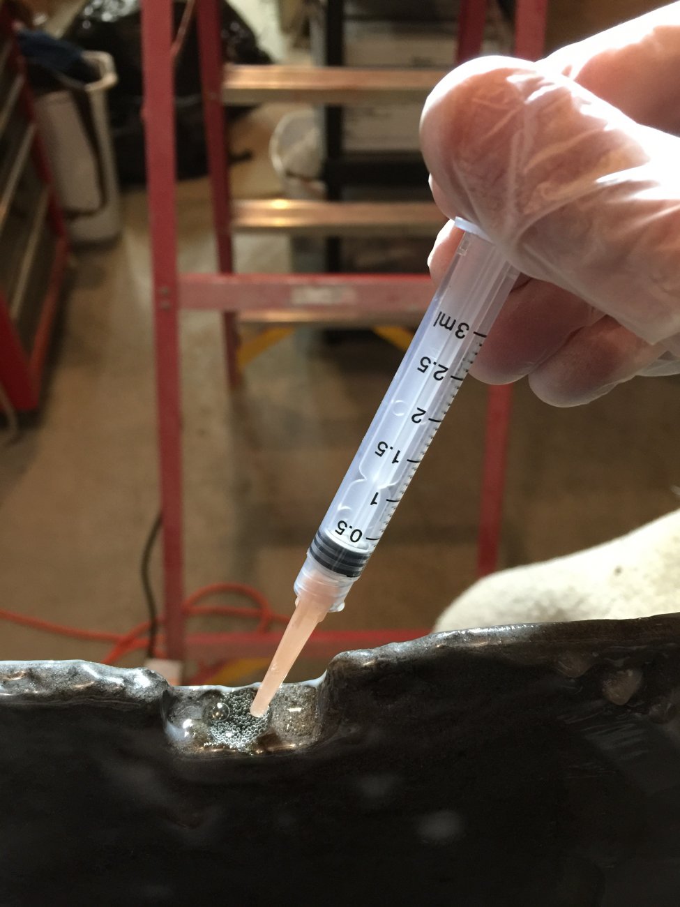

My .02: Epoxying over the entirety of the Eye is not likely to produce the results (waterproof) you're looking for.
Rather I would (and have as others have done):
1) re tap / clean the threads on the keel, adjust depth as needed or warranted
2) clean the hole with reckless abandon
3) fill the entire void with unthickened West epoxy
4) Before it kicks-- pull out the excess
5) upon re-installation Locktite blue on the eye-bolt and send her home

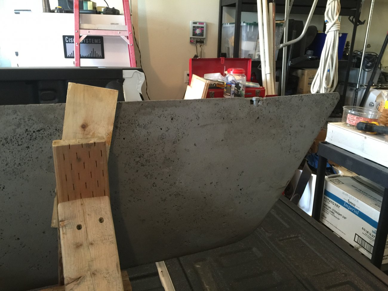

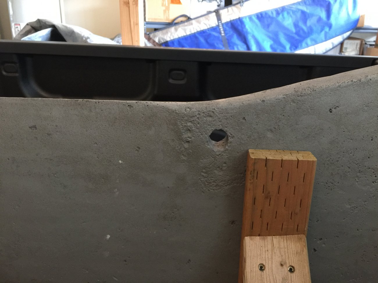

semi- sequence of events below including some nasty before and after ;)
Apr 11, 2017
571
Catalina C22 Solomon's Island, MD
That's a heck of a clean looking job on your keel PC. How did you get down to bare metal so well? Looks good-
Likes: pclarksurf
Jul 13, 2015
931
Catalina 22 #2552 2252 Kennewick, WA
@Hardhead Sandblasted ($200.00 cash) followed by a quick dousing in unthickened epoxy to start the maddening layers of buildup I had to do to match my OCD ;)
