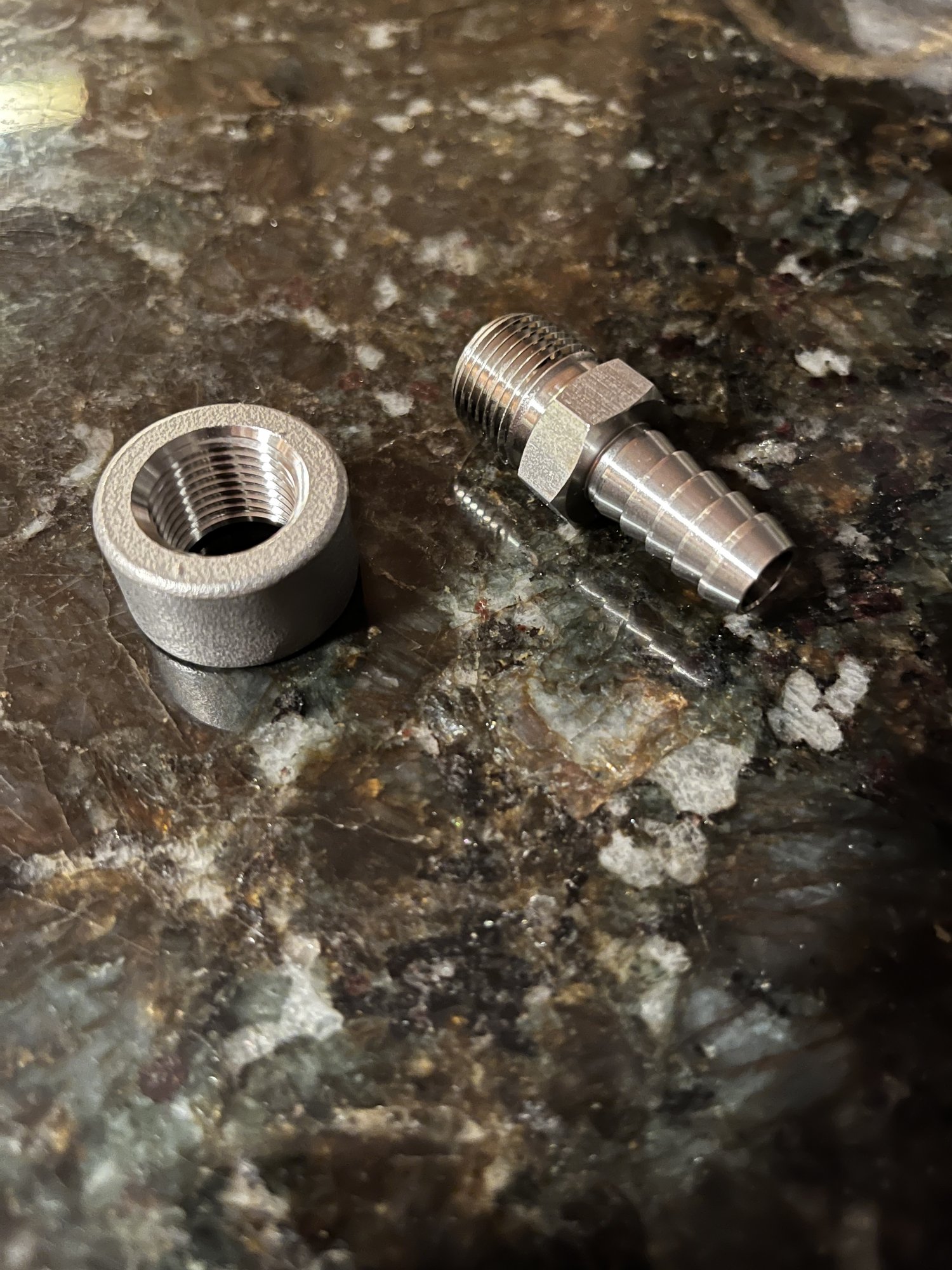

So have a project to do with epoxying a threaded coupling to fiberglass. A male npt / 5/8 nipple will be screwed in for a 5/8 hose to be attached. Is the adhesion between the stainless and epoxy strong alone when done correctly? I do intend to put a couple wraps of cloth at the base as well.

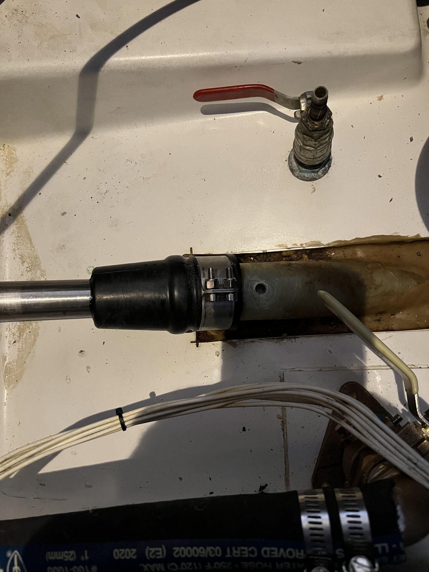

Ha yes very vague indeed. Beneteau has a water feed to the shaft tube which is made of fiberglass. The water is necessary for the volvo dripless shaft seal. They had a bronze fitting tapped into it with only a couple threads at best, then had a wad of epoxy surrounding it. Was water tight and it’s in a place that is relatively safe from impact, however fitting complete corroded. Yes it is below the water line. I have a small peice of 1/4 inch thick fiberglass that I will drill a hole into and set the stainless steal fitting in,, then plan to expoxy that onto the tube. The picture is of the cleaned up hole that the fitting will sit on top of.

So I did a test with just the threaded joint epoxied only at the base……. Let it cure for 15 hours and it is very attached. I screwed the nipple in and torqued it and the thing didn’t budge. So I think with the extra that I am doing which includes a couple wraps of cloth should be more than adequate.

yes indeed…… mine was completely corroded. When I went to remove the remaining peice it crumbled. I am going to use stainless steel as a replacement (see above photo). When done it will be quite robust.

By the look of it this a standard Volvo lipseal. Volvo does NOT mention this arrangement with the water hose. I have installed this volvo lipseal in our boat a couple of years ago without this hose. Volvo DOES insist that you “burp” the seal, that is compress the bottom upwards to create a leak between shaft and seal. You have to do this after a haul out to let the air out of the shaft box, so the outer lipseal gets lubricated and cooled with water. For the inner lipseal you have to introduce a small amount of waterresistant grease once a year. It is pretty maintenance free.
I suppose Beneteau (Edit: sorry I mentioned Volvo here) made this arrangement to mitigate for owners not applying the Volvo instructions.

I burp and lightly grease every year. Maybe volvo doesn’t mention it because every set up is different. Beneteau has a fairly long shaft tube with a cutlass on the end that does not allow significant water to back flow up into the shaft tube to cool things down. No cutlass strut.
The set up so far the way it is designed works flawlessly.
