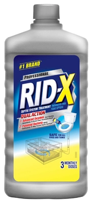

I like @dlochner 's idea about a strong detergent. I have also wondered about using products designed for septic systems. I'm thinking about something like RidX liquid
I don't have ANY experience using this on a boat but I have used it a lot. I raised a family of 4 kids (6 of us in total) in a house on a septic system. I was very diligent about using this once a month. After 15 years we had the septic guy come out to pump the tank and he said it didn't really need it. Everything was still open and flowing. This is enzymes plus "good" bacteria. I can't imagine how it could hurt to try it.
