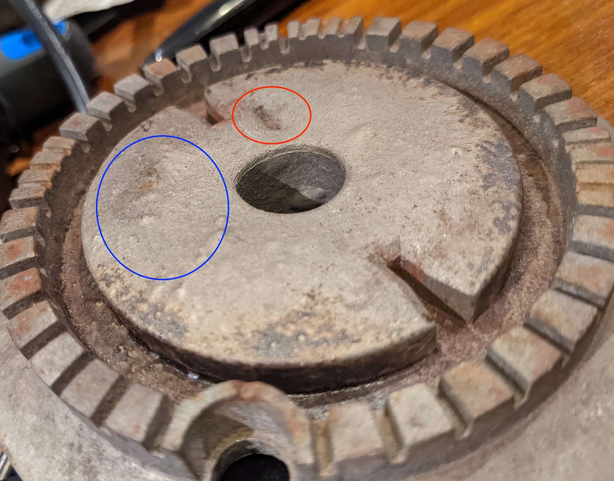

My propane eno stove burner has a spot throwing a yellow flame. It stinks and gives me a headache.
First, is there anywhere to buy the part below?
Seconds, as it's only one spot, I figured something is plugged, but I don't see blockages. However, it looks like the surface where the gas would mix is bubbled up (blue) and near puncture (red). The yellow flame is would be straight out from indentation. I purchased some thermal epoxy to fill it in. Any chance of success down this route?

Have you tried special order from places like SBO Shop, Defender, or Fisheries Supply?

You do have a working carbon monoxide detector?
