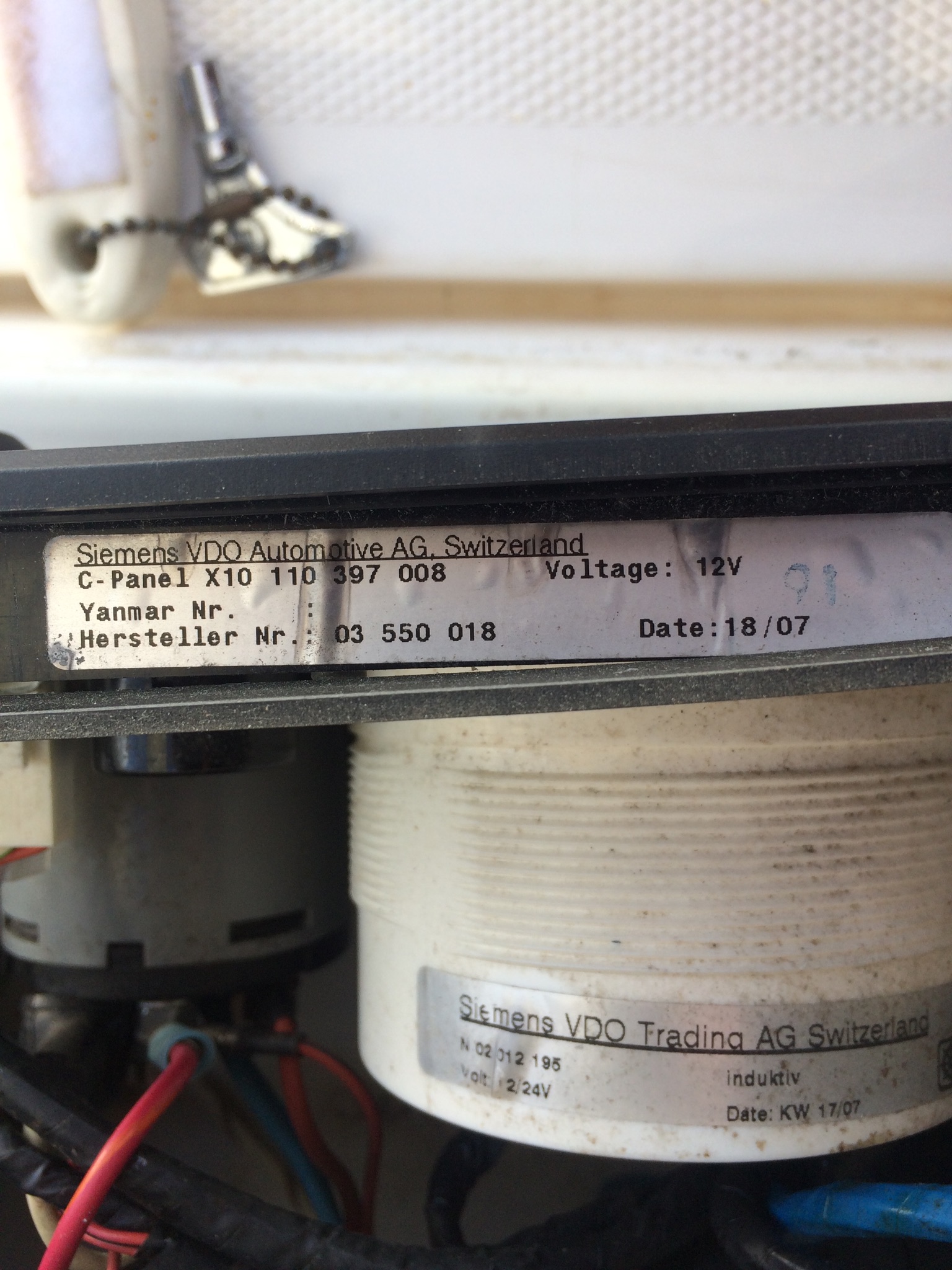

What struck me was that along with the engine stop button not working the indicator lights (fuel, temp, etc) also are not working and when I looked behind the panel both the button and the indicator lights were connected to the same unit that appears to be a circuit board.
Tomorrow I will take a better picture but for now I only have a picture of the face of the panel and the part number information.
I’m new at this but I’ll try to attach the pictures.
