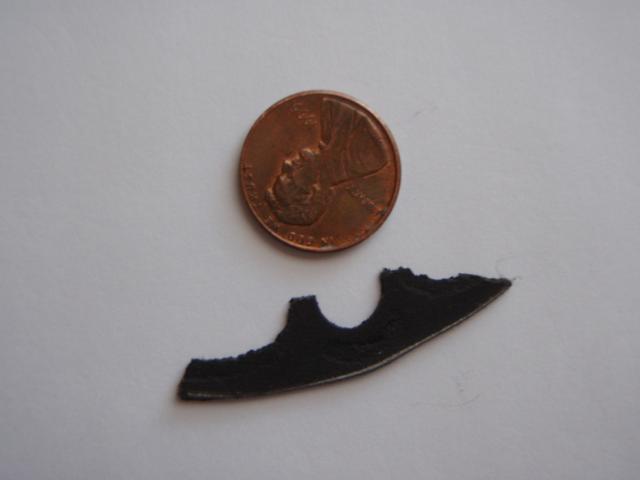

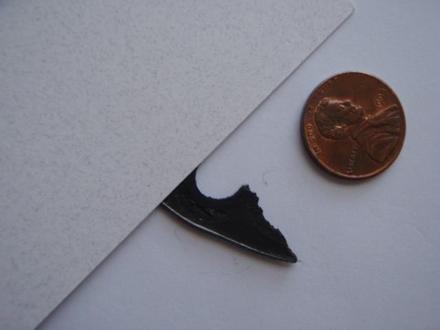

Pictures of Gasket
Thanks for all the advice thus far
I have enclosed 2 pictures of the piece of broken gasket material
The 1st picture shows the piece after the mechanic pulled it off, while the second piece tries to reproduce what I saw with the flashlight and mirror when I was looking for the leak under the engine. Only part of the gasket was showing when I origianally saw it
Remember, this is a gasket behind the main engine pulley, behind the fuel pump, behind the timing belt and whatever, and jions the front of the engine to the engine block. This is a static part, and the bolts that go thru it are as originally installed by the factory.
As I said in my original post, I believe the yard I deal with is a very reputable Yanmar approved repair facility. They have said they will not under take this repair. I know they would like the work, so when they tell me to send it to a major Yanmar repair facility, I know they are being honest.
John

John, Is that a 3YM 30 ?? If so there are only three gaskets in that area, all of which should be a medium level job for a mechanic. Definitely not a reason to pull the motor. The gear case-to-block is probably the one that let go. Of course this is the most difficult one to replace but it really is not that bad of a job. The other two that may be leaking are the oil pan spacer-to-block and the oil pan gasket to the oil pan spacer. A gasket on a case like this may fail slowly. It should have leaked for a while before blowing out. Usually the gasket will compress and then the bolt becomes loose. At that point, it should have started to drip very slowly. If the cover had been re-tightened, most likely the gasket would be fine. Did the mechanic verify that the crankcase breather is free and clear? A blocked breather might do this also. On the YM 30, the oil in that case is not under pressure, it is being poured back into the oil pan, having lubricated the idler gear and camshaft gear and the oil pump itself which is in the top starboard corner of that case. When the case is pulled, get them to check the oil pump and pressure regulating valve just to be sure. Best of luck with it, John.
