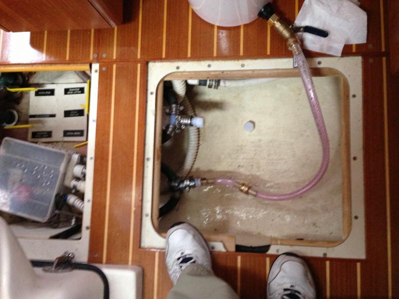

This is what I offer for my customers for just the engine. Everything gets itemized..
Standard Engine Winterizing:
Change Both Fuel Filters
Bleed Fuel System
Run Engine To Warm Oil
Change Oil & Filter
Clean Sea Strainer
Change HX Zinc (if applicable)
Check Engine For Leaks
Check All Hoses & Clamps
Check Motor Mounts
Change Transmission/Gear Fluid
Suck In AF Until It Matches Bottle Strength Out Exhaust (usually 4-5 gallons)
Drain Water Lift Muffler (if it can be)
Drain Engine Seacock
Loosen Alternator Belt
Inspect O-Ring On Fuel Fill & Replace If Needed
Check Throttle Advance and Shift Cable Adjustment
Check Engine Idle Speed
Optional:
Remove Impeller & Replace With New At Spring Commissioning
Check & Inspect HX
Coat Engine With Rust Inhibitor
Send Oil To Blackstone Labs For Evaluation
Probe Fuel Tank For Water, Remove Water If Found & Polish Remaining Fuel
Second Oil Drain & Fill To Ensure Very Clean Oil Sump
