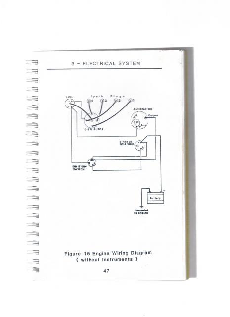

I got the book out and can copy the wiring diagram. I can also get the trouble shooter for starting.
