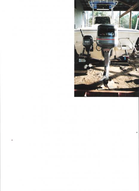

Carolyn,
There's a brand new Garelick motor bracket made for 4 stokes from 7 to 30 HP with a 9 inch travel and will handle up to 169 lbs for a buy it now price of $287 on eBay. This is a steal. Just type in outboard motor bracket. I tried to send you a PM about the very heavy yamaha 9.9 4 stroke I had mounted as an auxillary on my 22 ft. proline next to my 150. I always trailered it on the bracket in the raised position. NEVER any problem! I did have it cable locked to the bracket so nobody would steal it. You just don't want to have to unload a hundred pound motor from your trunk or truck, lift it up and mount it to a bracket each time you go sailing, not to mention hooking it to a battery if it's an electric start.
