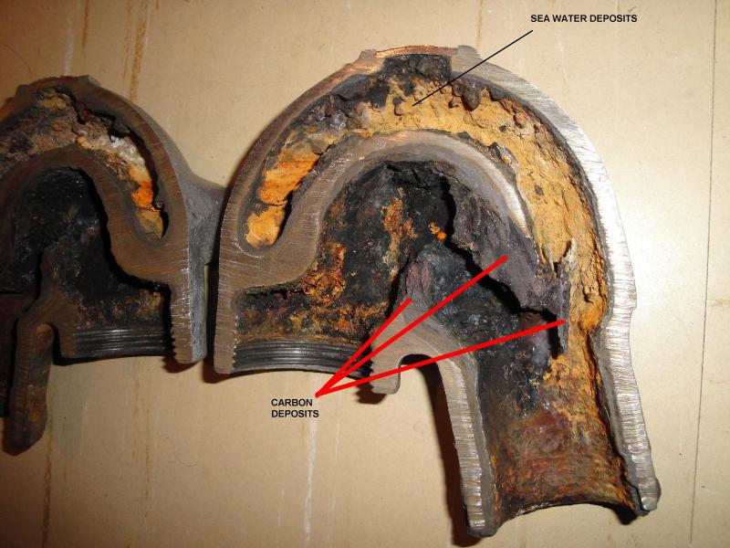

.................. says this is the culprit.
Thanks Ralph Johnstone. This is our 1st boat so have alot to learn. We had both the exhaust elbow and the mixing elbow replaced in August 2012. Do you think it could be bad already or clogged up?
2012 is a little recent for the elbow to plug up but it's the easiest/cheapest thing to check after the new fuel filters you've installed.
