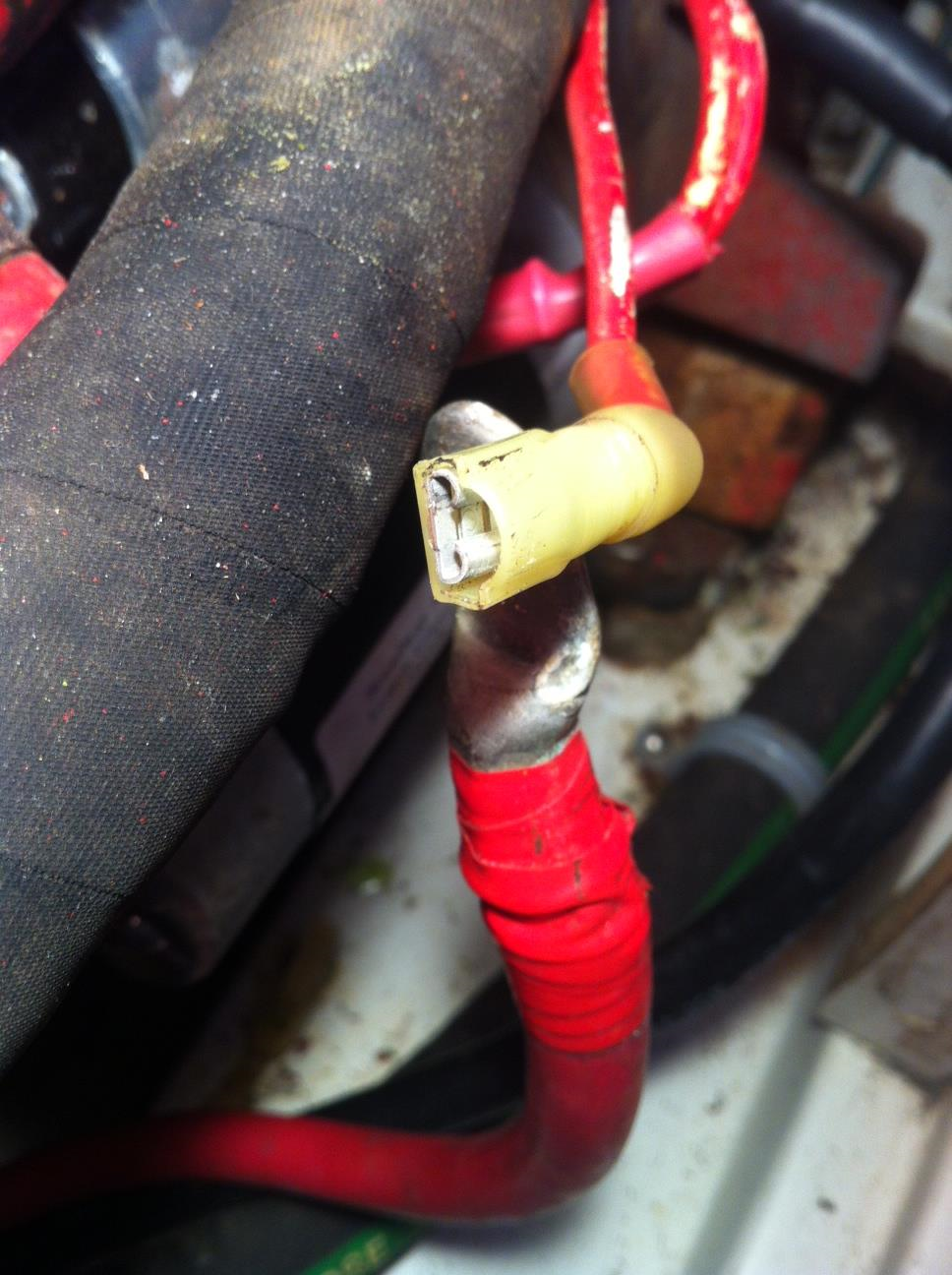

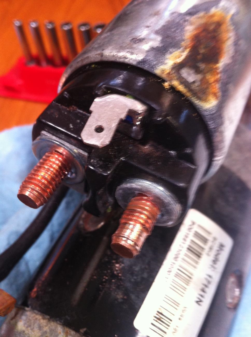

I found the problem, that being a wire that is a spade connector at the starter not being firmly attached. But wait for it...there is more to the story. We have owned the boat a year now. One thing the owner did is have a new starter installed as part of the purchase deal because of a corrosion issue. As I was troubleshooting today I was rooting around the wires at the starter ( I had already traced power to the alternator and coming out of the alternator and power was disappearing at the starter. ( see attached photo of the wire diagram where the power was disappearing. Suddenly I had power, I heard the fuel pump start up and the control panel lights were on. They...poof...it was gone, Ah ha I found the problem. Then checking the connections on the starter I found the wires were loose. When I tried to tighten, the nut would just spin. See the discovery of a stripped copper connection in the photos. Oppss...guess I need a new starter and I'll fix this one for a spare when I find the time.

Glad you found it. I've said it before I really dislike those push on connections Give me a bent fork or ring anyday.

I wish I had a way to modify the setup. As it is I now have another project on my list. I will be adding a separate push button switch for the starter and one for the glow plugs. I also found some rust on the engine block I need to address sooner than later. I'm thinking of soldering on a push on connector with a lead wire with perhaps a terminal block or something so this can't happen again. One thing I did discover is that there is plenty of room in the engine instrument pod for a 12 volt plug.

Here's an idea for you. See if you can chase the good threads that are left on the stripped stud with a die. Then have a machine shop make a stud on a lathe that will screw on to the existing stud and have a new stud on the other end to attach your wires. Shouldn't cost much or take very long to make what I am talking about, especially an easily machined material like copper. It looks like you have at least three good threads left on that stud which is adequate for full strength of the joint. If you can't get a die on it sometimes you can use a knife (very carefully) and carefully follow the good threads until you reform the last thread to allow a nut to get started on the remaining threads. file down or cut off the damaged portion if it is too big in diameter to get a nut to the good threads. Basically what you need is a copper tube threaded all the way through, screw it onto the existing stud and then use a copper screw through your ring terminal to attach your wire.

I got the nut onto the stud ok with out lock washers. I have a rebuilt starter I'll be picking up next week and then I can have the solenoid rebuilt. Its ok for now but...not a long time solution. Thanks everyone
